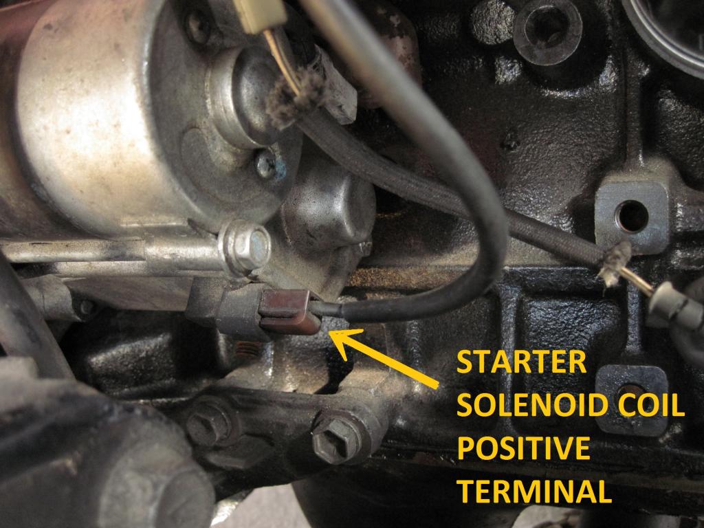

Originally Posted by perryT200
...the starter will try and engage again...
Does it sound like flywheel mechanically grabs the starter gear and turns with it, OR
Starter motor electrically turns, and engages flywheel as if ign switch were put in Start position?
Try this:
While idling as above, disconnect spade connector from starter solenoid and see if symptoms persist. Then report back.
