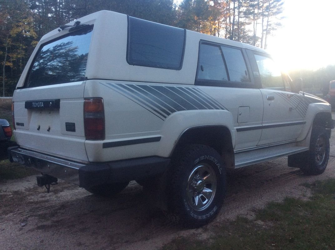

ouch. unfortunately, those running boards were not toyota, but rather, specialty items, added either by dealers or dedicated custom shops. i have a set on one of my '87s. your best bet is going to be used, either via auction sites or a junk yard.
the same custom shop/dealer added the rubber "door guards/bumpers" along the lower edge of the door and rear quarter.

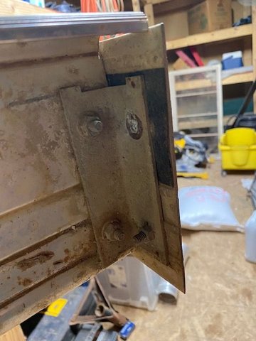

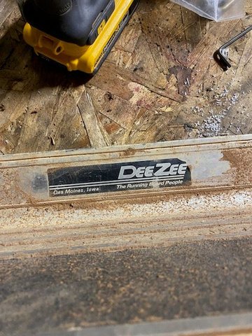

more information that may be helpful:

Thanks again-- I'll check it out. Right now, my plan is to get some sheet aluminum the same gauge as the other side, trace the other side and then cut out a duplicate with the new aluminum and paint it, then JB weld some washers around the ripped out mounting and reattach it. I'm pretty sure that the mount piece in the wheel wheel is aluminum-- I might have to put some rubber spacers or something in the wheelwheel mount to avoid bimetallic corrosion: it doesn't look like the other side has that but it can't hurt. I'll have to hammer the board itself flat at the front since whatever I hit bent it up, but I think I can bend it back once without cracking it. Then I should be able to just screw everything back together. Fortunately it's not a complicated shape or anything so I think it should be pretty easy to snip out and fabricate a replacement. Famous last words lol.
