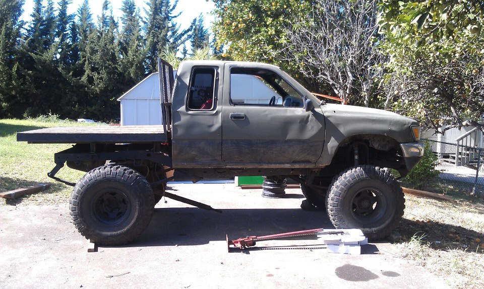

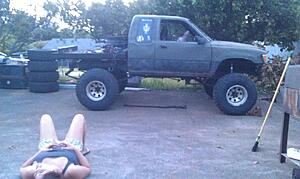

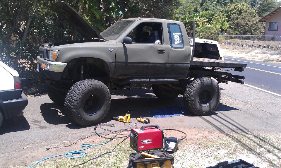

I did a 3rd gen single to excab swap... I took 18 inches from the front of the bed, Had to relocate the gas tank and chop into the cab to go around the frame to keep it low as possible. Ended up making a flatbed and moving the hangers to the rear of the frame. All in all, love it. Great stance, the wheel base is the same as my 85 4runner with a bobbed bed.
