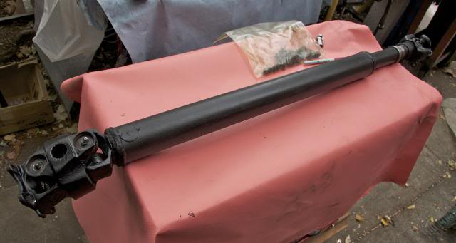

Your problem is probably drive shaft angle as fishguy said. I went through the same issues after I added leafs and longer shackles in the rear to match my front SAS. I ended up adding a CV joint to the drive shaft. Shake 99% gone. [IMG][/IMG][IMG][/IMG]

Rear DS with CV.
