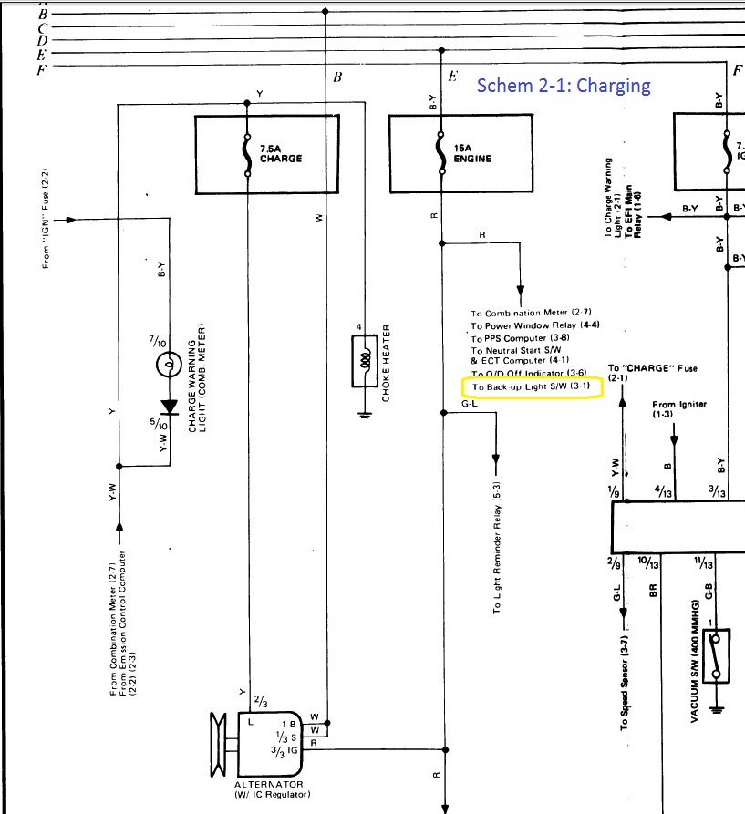

Both 4WD and back-up pigtails meet in a "Y" above the transmission and somewhere behind the starter, then the bundle goes up into the main harness right below the throttle body.
Peel insulation from the "Y" and find matching colors, Then verify by checking continuity with points in schematic.
Red is 12V from Engine fuse.
Check voltage there with IGN on and engine fuse INstalled. Should be 12v
Leave IGN ON. Check voltage with Engine fuse removed. Should be 0V.
The other wire from the the back-up switch (sorry, I don't have schematic handy) runs back into same "Y" and eventually to backup light "Positive" terminal. Check continuity between those two points.
Back-up light wiring takes +12V from engine fuse (15A)

A) Look at schematic,
B) Strip the loom,
C) Look for wires with colors matching pigtail from switches and schematic
D) Do voltage checks to verify you have the correct ones.
