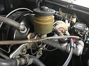

I'm gonna bump this thread,
I have all the parts needed to do this swap on my truck, but I noticed that there is a rubber spacer behind the dual diaphragm booster.
Does this spacer need to be installed on a truck?
The booster came off 94 runner, maybe the firewall is different than my 88 pickup.
If you have done this mod, how did you handle, or not, the spacer?
