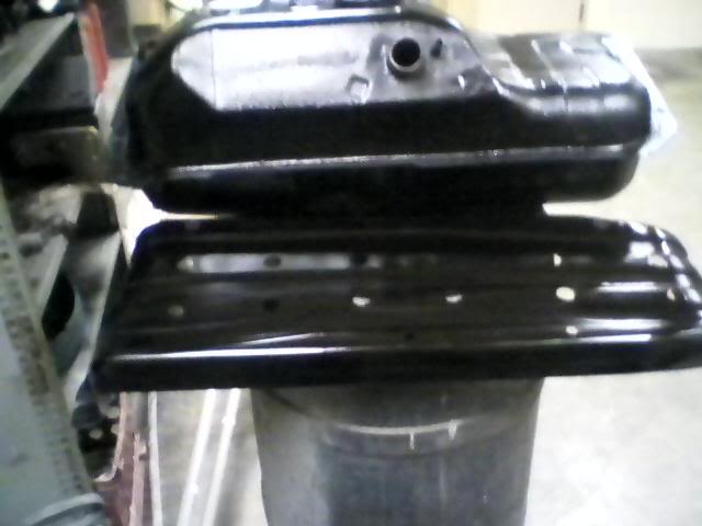

This is a 22r carbed pickup tank. The fuel pickup assembly and the fuel float level assembly are similar or the same size on top of the tank. I dont remember which one is which as far as float or fuel pick up assembly at this time.
A fuel injected tank has alot larger hole for the fuel pump assembly to fit thru and has a silver ring that would stand out as well.
This came off a two drive truck and I do believe there are tank size differences if it doesnt look exactly like yours.
The 2 inch size fill pipe is to the front or on the right of the half inch vent line.

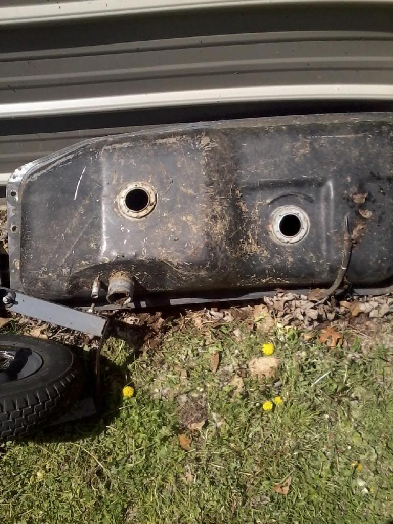

Silver ring and larger hole on a fuel injected tank. Finger is showing line that likes to clog on another post. Just wanting to show the ring I was talking about.

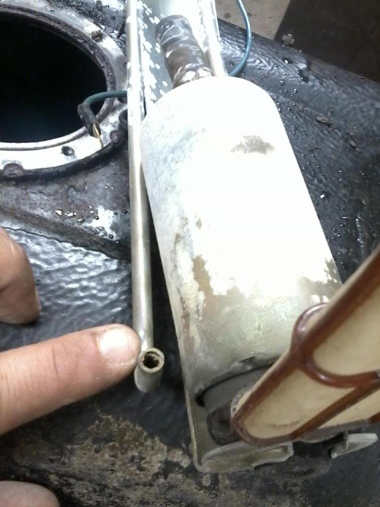

4Runner tank with the fill tube to the rear and vent to the front.
