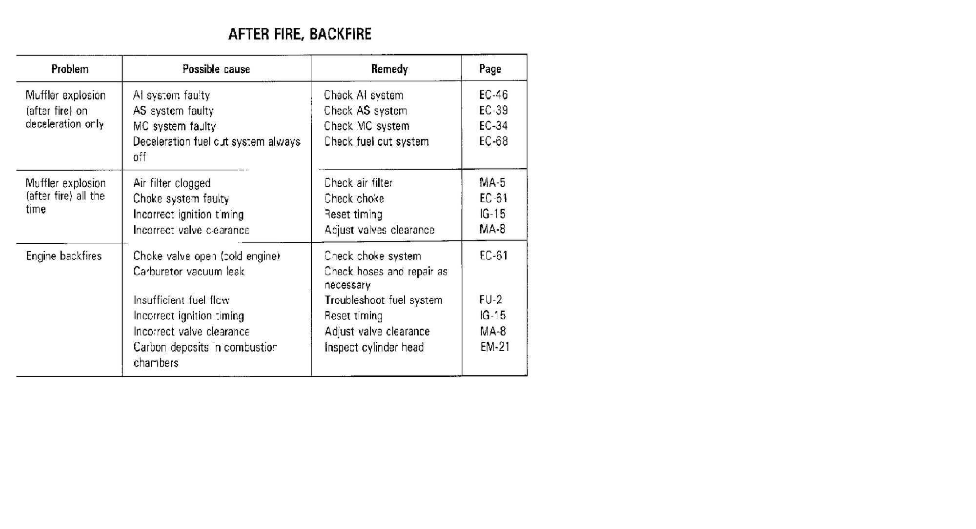

Anyone found a solution to this, my 85 engine is doing the same thing. I figured it was timing or fuel related, testing one thing at a time because I don’t want to throw parts at it.
Old Oct 10, 2024 | 01:10 PM
prcnctoyo's Avatar
Joined: May 2011
Posts: 236
Likes: 45
From: North Carolina
This is from the FSM. Got a copy of it?
