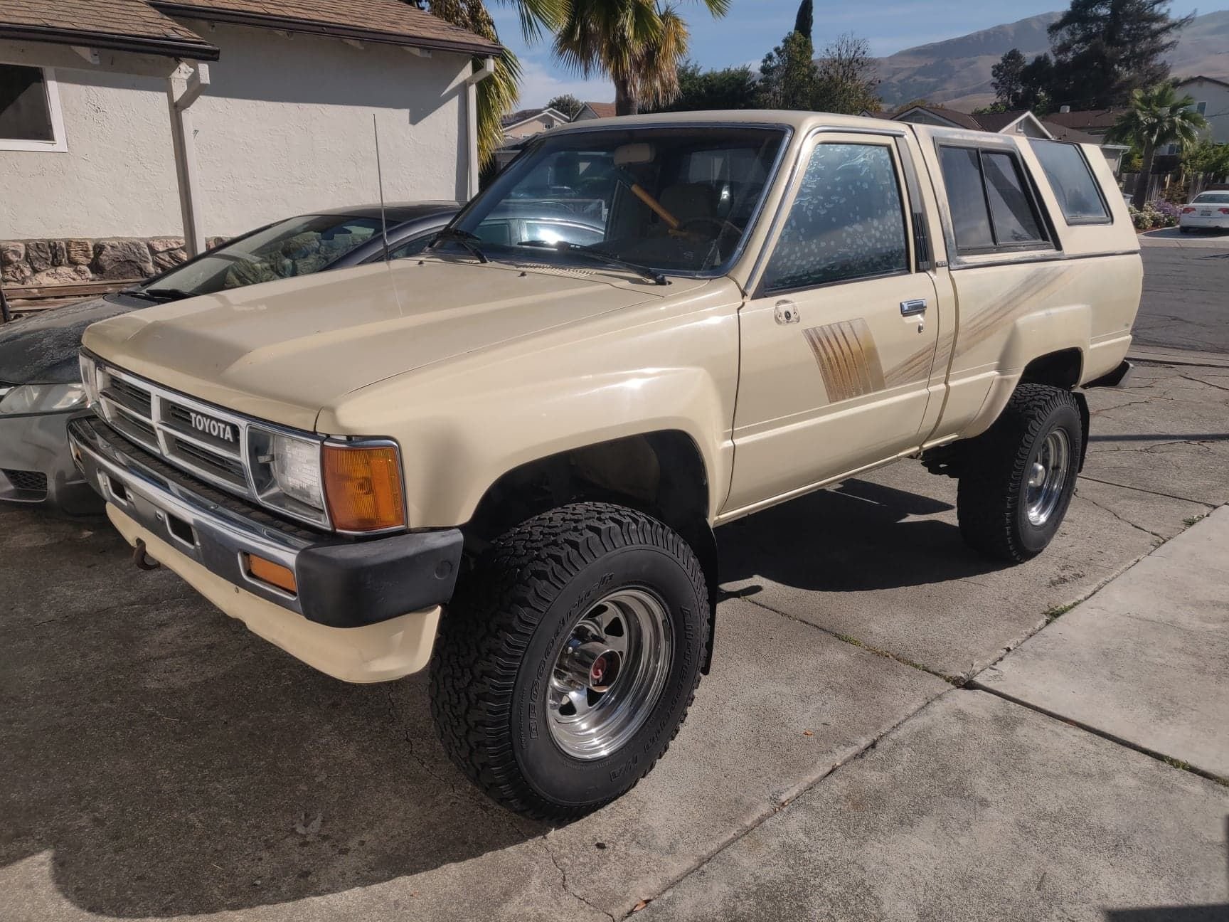

Hey everyone. Long time lurker.
Location: Los Angeles, California
I just picked up a 1987 Toyota Pickup 4x4 w/ a 22r (110k miles). Truck needs a few things here and there but one thing I noticed was that there was a strong gas smell in the cab when driving. Took it to my Toyota mechanic and they diagnosed a bad Carburetor. Apparently the truck had sat for years and the owner before me decided to turn in on and run it with the same gas that was in the tank. Mechanic says the old rusty fuel killed my fuel sender unit and ate up the entire carb, from the inside out, beyond repair (Havent yet seen the carb so not entirely sure if its trash or can be rebuilt).
Unfortunately for me, I live in California and so I have to get a smog every 2 years. Any idea what options I have as far as carburetors go? Weber only had CA legal carbs for the early 80s models and from what I've read online, CA trucks come with a CA model carbs needed to pass emissions?
Am I just ˟˟˟˟ out of luck and need to find a donor truck w/ of the same year/model? will a 2wd model or perhaps a different year work?
The only thing I have going for me is that my local smog shop doesn't care about a visual inspection and just cares that the tail pipe exhaust test passes.
Appreciate any feedback or suggestions
