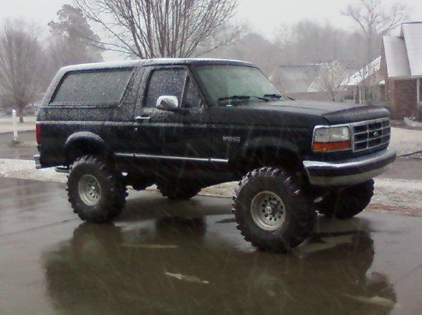

i have a 96 bronco w/ 36' tsl's and 351 and i love it but the gas mileage is killin me and at 16 minimum wage is hard to keep it moving lol, but ive gotten a bunch of offers to trade and one guy has an 87 i like but it has no lift and i looked at some other 87-90s at school and online and all of them have the same 4.5 to 5 inch lift, is there anybody that makes a kit bigger than 4 inches? i want to do a sas someday but not now since its just to drive around town
