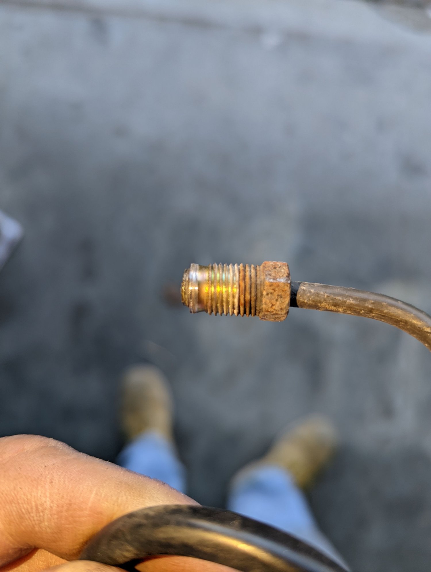

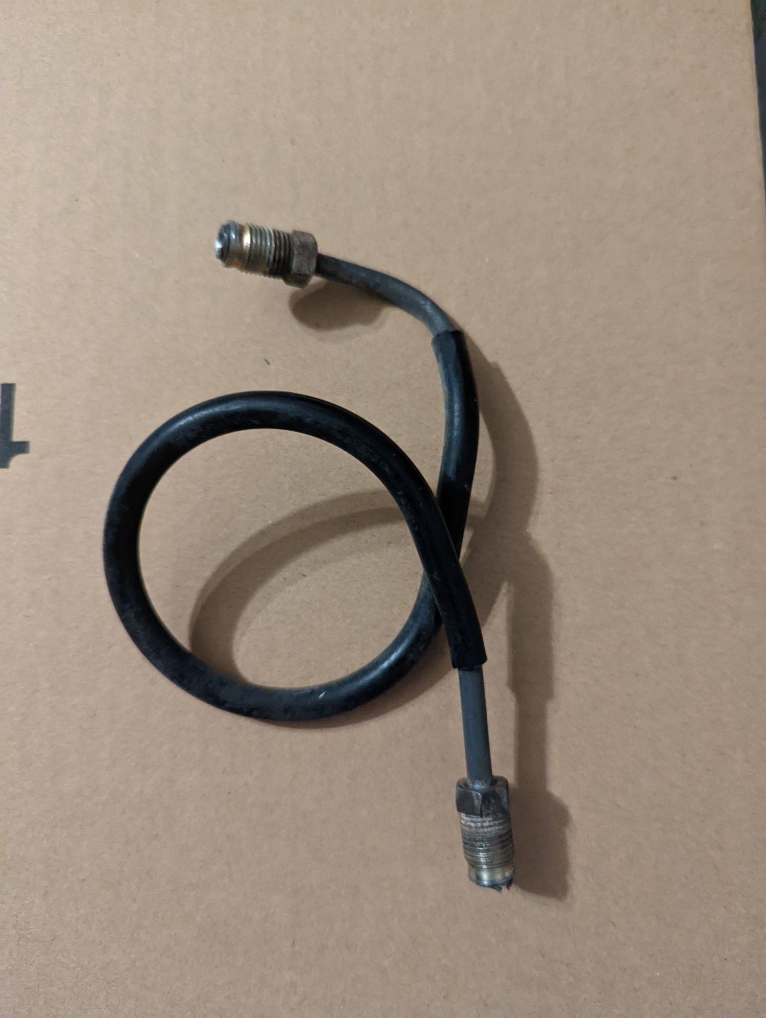

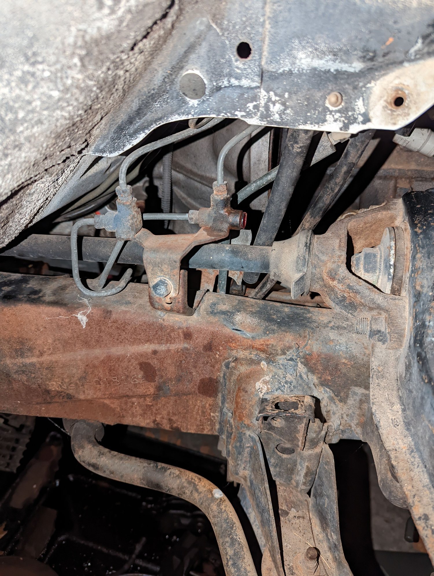

Looking for a passenger side hard brake line that goes from the distribution block to the brake hose leading to the caliper. Took my old brake line off and couldn't install the new line since the flare nut mushroomed out to match the flare.Pics attached.
Original Hard Line
Pass side distribution block
Mushroomed flare nut

I purchased some pre-flared straight sections of brake line from the local parts store and hand shaped that one when I replaced it. Just make sure to get the right flare. My parts store has them labeled as "Japanese Flare". Just need to be careful forming it, you don't want to kink it.
