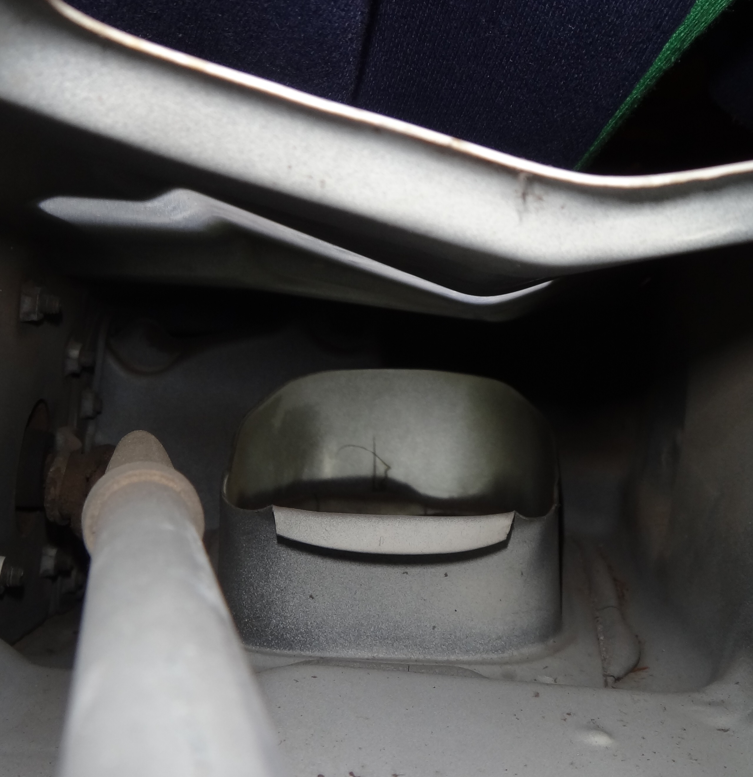

With the Cowl Louver pulled off, I was able take this photo of the air intake duct that sits directly over the blower fan. Had to shine a flash light up the blower housing to illuminate the far wall of the duct shroud. The big rod is one of the wiper control arms. Theory is that water should flow around the duct shroud and out the fenders. Looks like there are some small cracks in the polymer filler material that seals the duct shroud to the body. If there was a build up of ice/slush/snow around the shroud, I suppose water could have gotten to the blower by seeping through the cracked seal. Next step if it is warm enough, I'll get the garden hose and dump some water in and see if anything is getting through.
