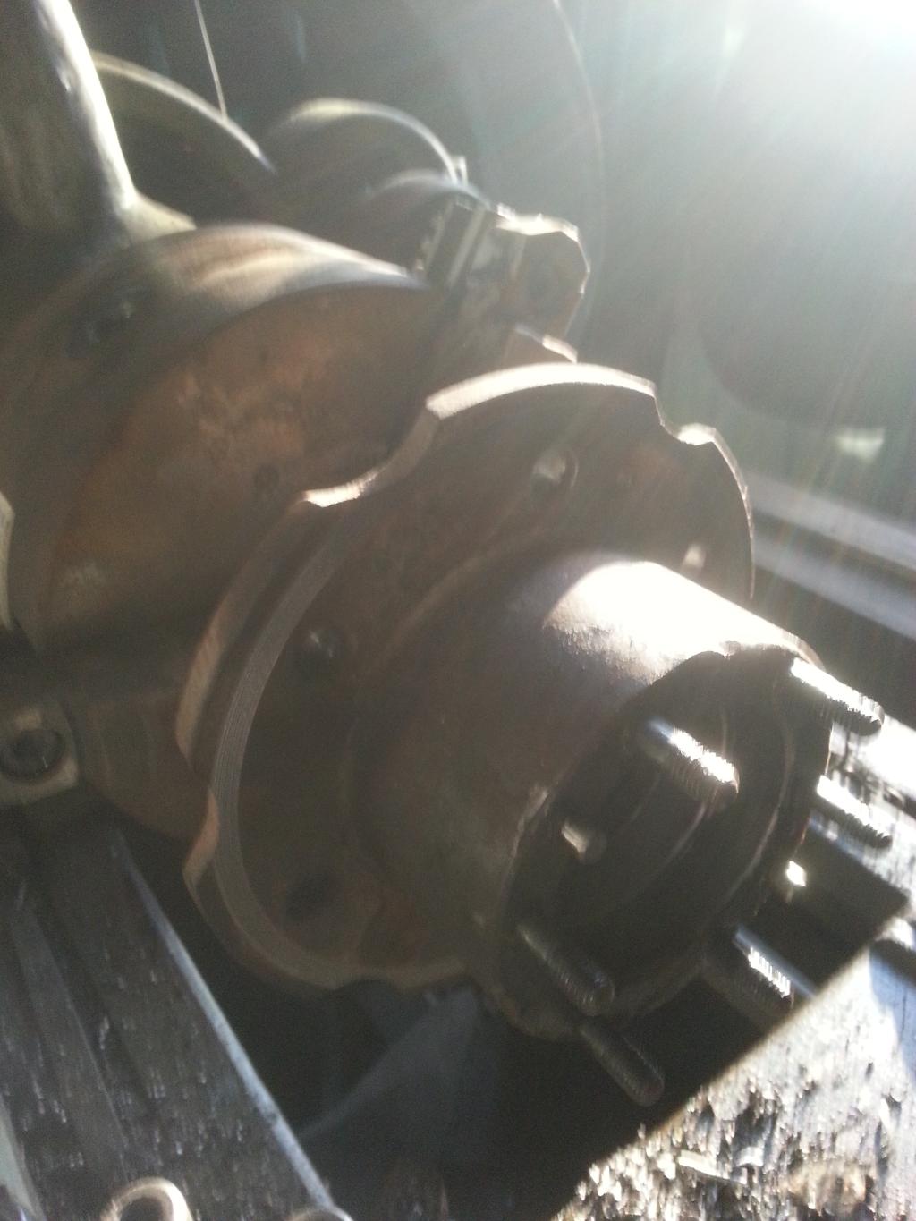

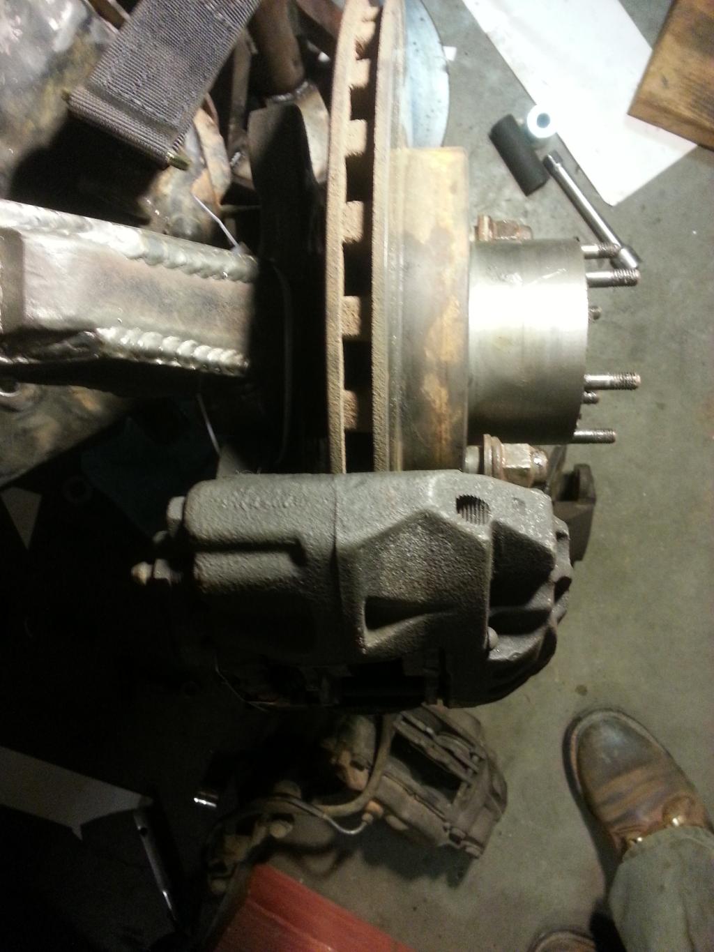

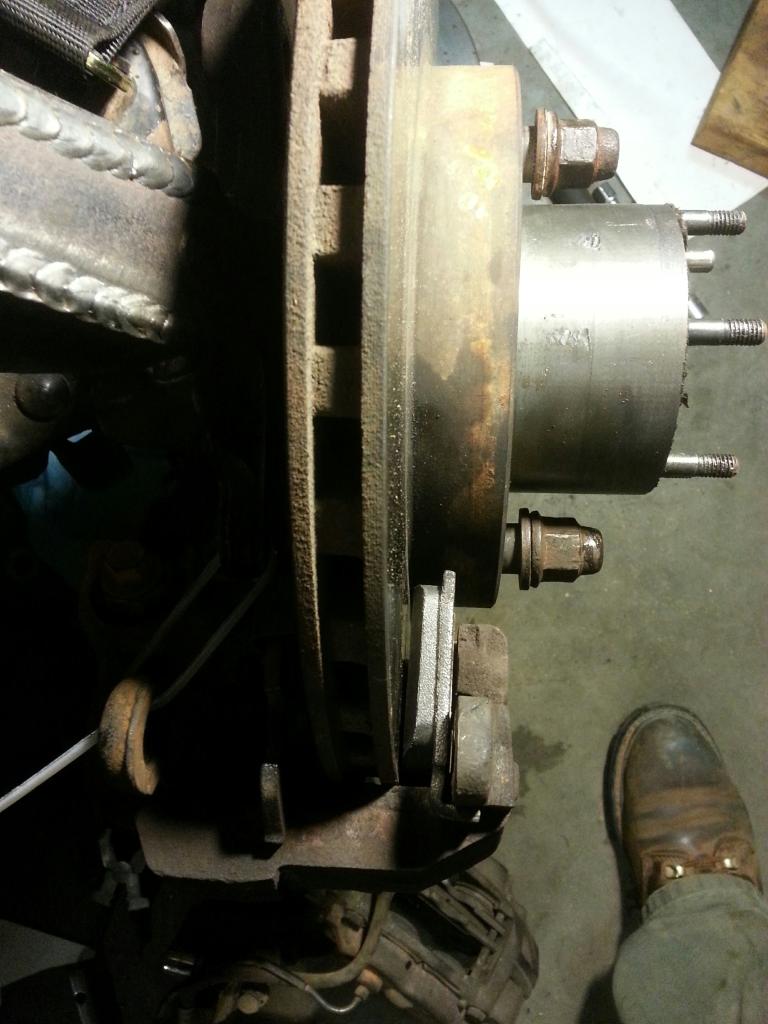

I did some work on the brakes. I had to machine the hubs a little to fit the fj60 rotors over them. I spent about 4 hours trying a bunch of different set ups until I finely got something to work. But now that its done other people can do it to. Fj60 rotors, gm calipers off a 96 s10 blazer.

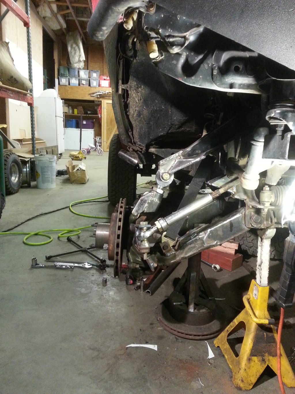

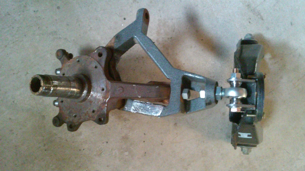

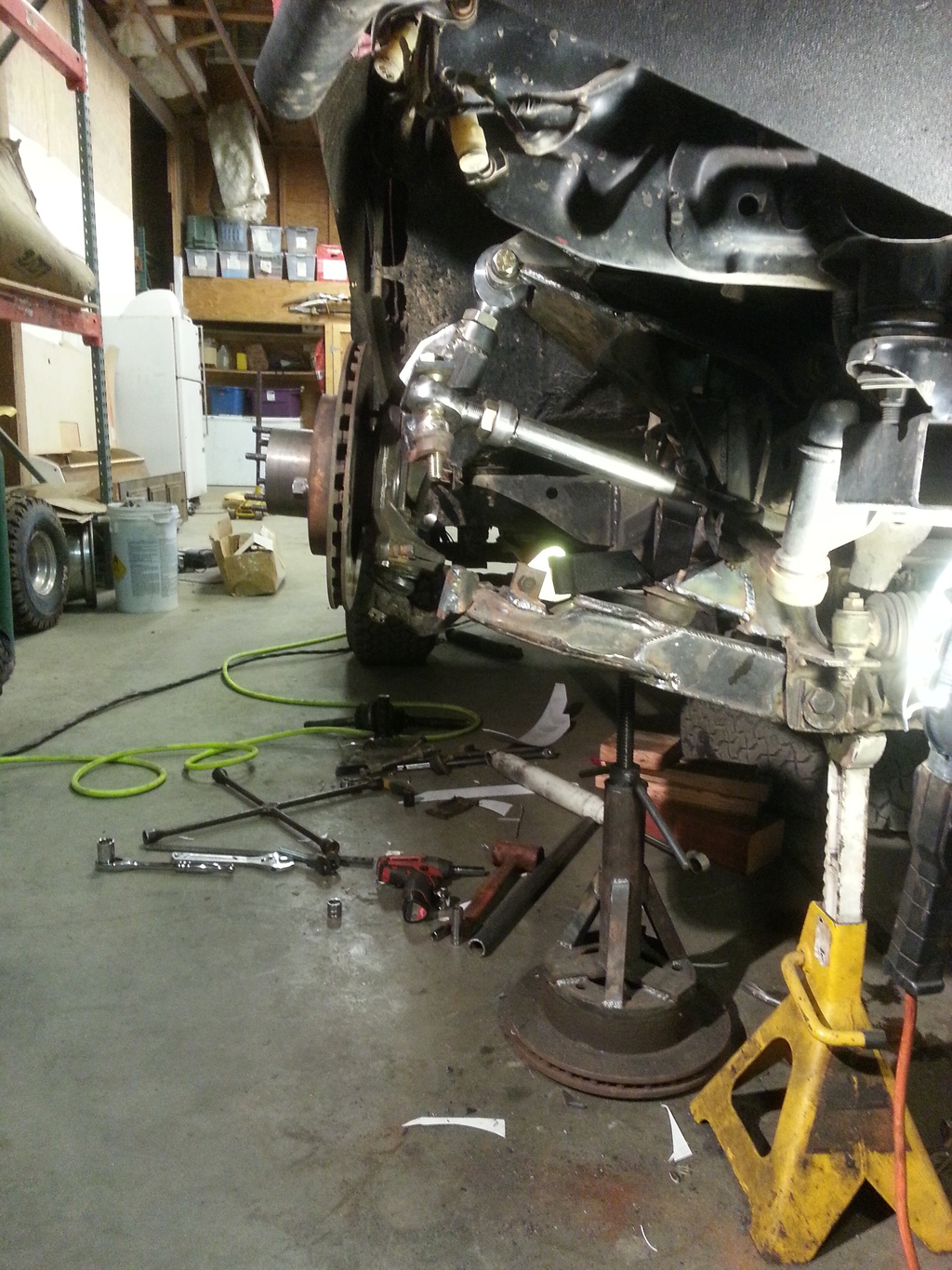

Little update. I got the bump stop, droop strap, and bump steer dialed in. And I also got the mount made for the brake caliper. All I need now is the shocks.Name:  20150331_160344_zpswkbpprde.jpg

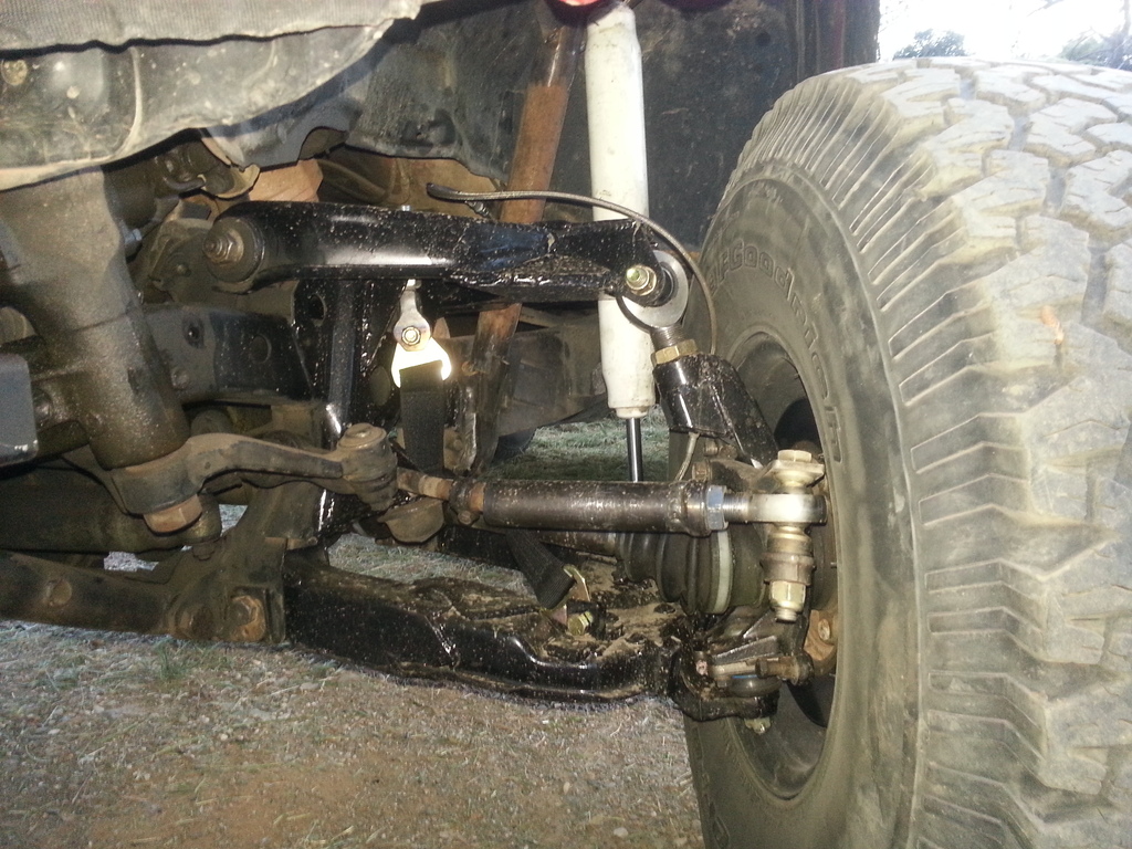

so I got it together last weekend to make a little trip to Fordyce. we didn't make it very far on Fordyce because of some Week steering. it was my fault I tried to make part of the stock steering work but it ended up just bending. overall I did pretty awesome but it still needs a lot of work.Name:  20150503_133413_zpsjxekilmu.jpg

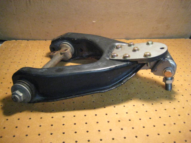

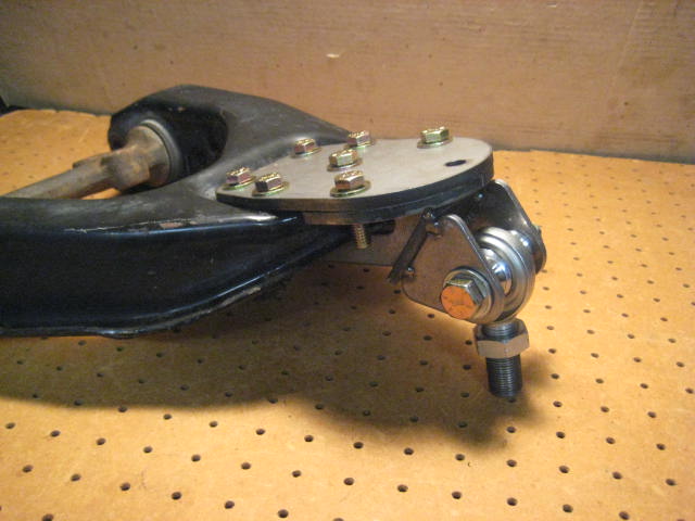

Interesting! I built a modified UCA Extension Bracket using a similar configuration using a Rod End. No longer is the upper ball joint a limiting factor in terms of travel. Be careful, the 3/4" shank will spin in the spindle upright, the jam nut cannot stop the rotation and your front wheels will soon end up pointing different directions and the rod end binding up on itself causing you to loose control. There are numerous other reasons its not a good idea to run rod ends in this configuration but that's another time. Suffice to say, if you build another set of LCAs (not using lengthened stock units) be sure they have steering stops, and make sure you adjust the limits or you will damage the Rod Ends and spin them in the spindle up rights.

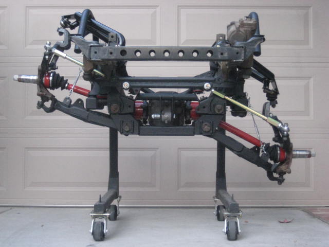

I know you referred to ccrraviotto's thread on center mount diff and how it got you thinking but I'm the one who got him thinking. He bought a Blazeland Kit back in 2010. Have you read about my "Mega Travel" set up?

Crazy how you built your Tie Rod Adjusting Sleeves! I've seen a few other people build them with equally poor attention to detail. Screams danger to you and those on the road around you! Hopefully you trailered your rig to Fordyce. Check out this guy on Pirate4x4
http://www.pirate4x4.com/forum/toyot...88-pickup.html
How did you move the spindle forward an inch? The UCAs / LCAs just look lengthened not shifted. Neither does the cross shaft and LCA pivots? How did you get the inner tie rod end to clear the center link / idler arm / pitman arm?
Good to see you messing with the sfa hubs / snouts. "LCAs/UCAs are 4.5" wide per side, Sfa hubs bring my wms back in 1.25" so my overall track width change is 6.5" overall" Its still pretty wide, FYI- messing with your rim backspace is an easier and cheaper route. Looks like the tire is almost rubbing the outer tie rod end. Add a drop bracket sub-frame and your gonna rub.

I've been thinking about your design and you may be okay as far as securing the heim shank to the spindle upright. When I did it, I simply drilled out the spindle to 3/4" then secured the heim in place using a jam nut on top and another on the bottom.

It rotated easily on the mock up, so actually testing it on the vehicle seemed unwise. I had done some research and had no luck of finding examples of mounting a heim in this configuration. I asked around and the consensus seemed to be this was a bad idea. When I showed it to a local race truck fabricator he heckled me with laughter untill he was blue in the face. He said it was a horrible idea. He said a 3/4" heim uniball was way too small for a spindle upright application, the minimum should be a 1" heim or uniball. More was said but I degress by by continuing on about it.
Anyway, it appears you did it slightly different than me because the threads are secured to the spindle by welding a nut or threaded bung to the upright. This would be less susceptible to rotation or loosening. As far as the 3/4" heim size, the shank is as big as the stud in the ball joint. Its a big as the bolt in a 1" uniball in single sheer. The 1/2" bolt is a double sheer pinning the heim to the UCA. And as for experts telling you it cant be done, that's what they told me about sleeving CV axles and a bunch of other things I tried that have worked well.
I say give it a go and beat on it. Just be prepared with some sort of back up fix / recovery to limp it back to the trailer. You be the Guinea pig and keep us posted.

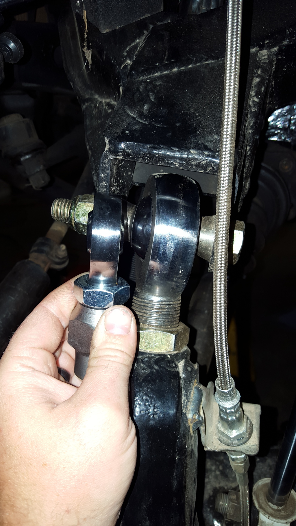

BlazeN8, thanks for all the comment, Ill try to answer as much as I can
The steering. Im actually really embarrassed by the steering, It was one of those really late night decisions to try and get on the trail, and it wasn't a good one. Thanks for the offer on the steering but im currently working on that, the outer hiems are 7/8 and ill be using 1.5" OD .25 wall DOM for the links.I also have access to a fuul machine shop and know my way around mills, lathes and cnc's so im able to make alot of different things I need.
I do agree that a different off set on the whels would be easier, but I very rarely do things easy. The most inset back spacing I could find for a 15×8.5 was 4.25, my current wheels are 3.75. So sticking with the stock setup and just getting new rims would have only got me in .5". Was it Worth the work? Probably not. But if I went to 17's thay would clear the steering and I could run up to a 5" back spacing.
One of the first things I did with the LCA was modify the spindle steering stops so that the hiem does not hit the missalinement at any time during the full travel. Also im running a 1.25" hiem. Here is a picture of it next to a 3/4 hiem.Name:  20150527_204753_zpskyb9ubtd.jpg
I would personally have to agree with the shop you went to, 3/4 hiem seems small, I would think It also were out realy fast. But im aslo the one who built the stuped steering.

Don't be too embarrassed about the steering links, its obvious to most of the readers and myself it was just a temporary thing. Building and testing new ideas and prototypes welcomes failure.
Building the steering is one hurdle the DIY guy has issues with. I get phone calls fairly frequently about the 17x1.5mm hardware. Its a odd size and its difficult to find parts or tooling for. Finding the RH and LH taps is an issue. The steering is the most difficult part of this equation in my opinion. You can use uniballs and heims in various configurations to gobs of travel but the steering just fights back. CVs are also a bear.
Okay, now that I see the close up picture comparison, I see its a larger heim. It looks like a 1-1/4" shank, 7/8" uniball, 5/8" bolt? You probably got the idea for a heim in the spindle like I did; sitting there looking at the steering and thinking what if I plugged a heim into the spindle upright. The 3/4 heim was what I used to mock up as I had it handy and it fit in the spindle upright with out enlarging the hole in a way that weakened the structure.
I was also not wanting to modifying the spindle with welding or plating. I also found that solving the upper ball joint just opened a can of worms for everything else. The lower BJ and steering issues develop immediately for a fraction of an inch of extra travel. Not only that, I found that clearance work to the upper BJ was so simple I couldn't justify the spindle modifications. A modified upper BJ can comfortably achieve 14" of travel. With some other tweaks to pivot geometry and mounting plate angle I designed a prototype that is in the 17" range.
I contacted Howe Racing a few months back in efforts to have them make a custom heavy duty, high angle, rebuild /serviceable ball joint similar to their Chrysler and GM units. I gave them my specifications and a couple of modified BJs as samples. Believe it or not, I am not the first one to do so. Howe is working on it, but its frustrating as its taking months and there is no solid answer as to if it is going to happen or not. My guess is it all comes down to will it be profitable for them to produce. Seems to me anyone with a 1986-1995 4x4 Truck or 4 Runner or 1994-1998 4x4 T-100 would love to by a set of these and bolt it in as a simple upgrade. Then there are all the other folks like us who are looking for big travel numbers.
