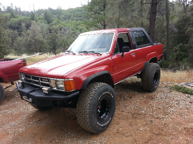

heres a pic,its an 86 not an 87,my bad

Welcome to the forum! Cool looking truck, I like the top chop.

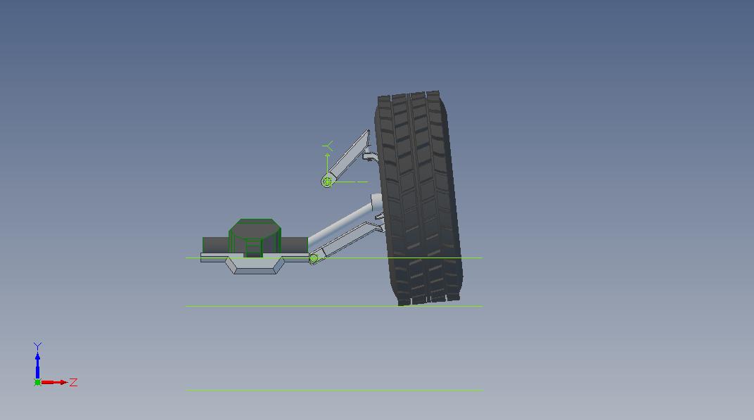

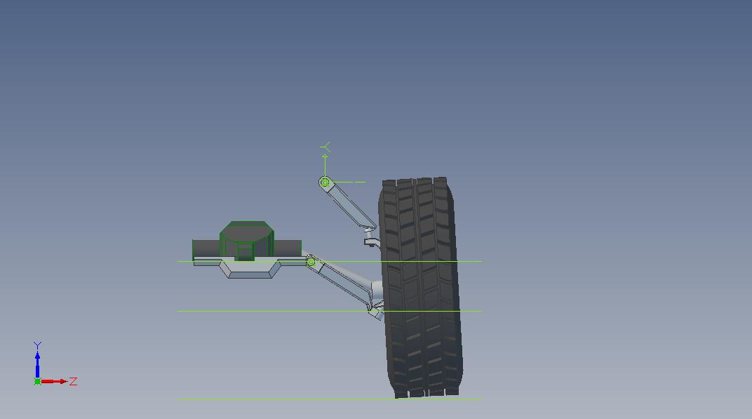

So i'm going to resurrect my old thread instead of starting a know one.
so because of some health problems i have allot of down time.
so here are the specs on my first design.
EMF uni ball upper ball joints
EMF outer TRE for steering
Center mount diff
Stock Wheel base
7 inch ground clearance at full comp and 19 full droop with 35's
12" travel
1-3" lift
-4 degrees camber at full comp
-3.5 degrees at full droop
ill add more specs as i go, im hoping to start some mock up next week.
here is some CAD pics
87 4runner,center mount ifs diff,mid travel or long travel?-assembly-rev-comp.jpg
87 4runner,center mount ifs diff,mid travel or long travel?-assembly-rev-droop.jpg

What are you going to use for front drive shafts?
What is your track width?
Bump Travel?
Droop Travel?
Nice Start
Old 07-14-2014, 09:07 AM
macgyveri206's Avatar
Join Date: Mar 2012
Posts: 29
Received 0 Likes on 0 Posts
Stock track width
With 1" of lift its a 50/50 droop vs compression
My goal is to milk as much out of stock width as possible.
Ill build my own axle shaft for now.

Here's an updated pic of the truck. I think im gona start a separate build thread and focus this on the suspension.

So I ran in to a little problem. Im running 35s and a 1" body lift in order to get the travel at stock width I will have to do major fire wall trimming so much that ill have to move my fuse box and computer. If i ran 31s then it wouldn't be a problem. Soooo
I can limit the travel to 10"
Or
Build a new sub frame and move the ifs forward witch has some major advantages accent angle, more clearance for the diff. I would have to build new UCA, new subframe, move the steering box forward just like you would doing a SAS.
I would appreciate any input/thought.

I wouldn't go through all that trouble. Just run the "limited" travel, which is still a major improvement and something attainable without all the extra work. JMO but so not worth it for a an extra couple inches of travel. Plus depending on the offset you might be able to run a 255/85, or a 33x10.5 with proper offset?

No its not centered yet.
I agree that moving it forward for a couple inchs isn't worth it but with a new subframe I can mount the UCA froward and in making them longer and I can do the same for the bottom witch could get me 15-16" travel.

Do you mean making the UCAs longer?
What are you going to do about CV length if the control arms are longer?
I'm about to go swap ball joints, so while I'm out there I'm going to see what happens when the CV travels 15". I would think that they'd bind-up before that, but honestly I've never tried.

Thay will definitely bindat stock width but by center mouning the fromt diff that give each axle an approximately 16" langth alowing for more travel. And for the UCA I was thinking something like the old Rancho uca but much stronger.

As to the forward subframe vs. stock, there's no way I would refabbing that but you are more confident in your skills than I am. No doubt that 15" of travel is preferable to 10". That's a significant increase. On 35s that's just ludicrously awesome to imagine!
You say you've got some downtime, so my vote is to go big.
Regardless of which path you choose I'm excited to see the finished product

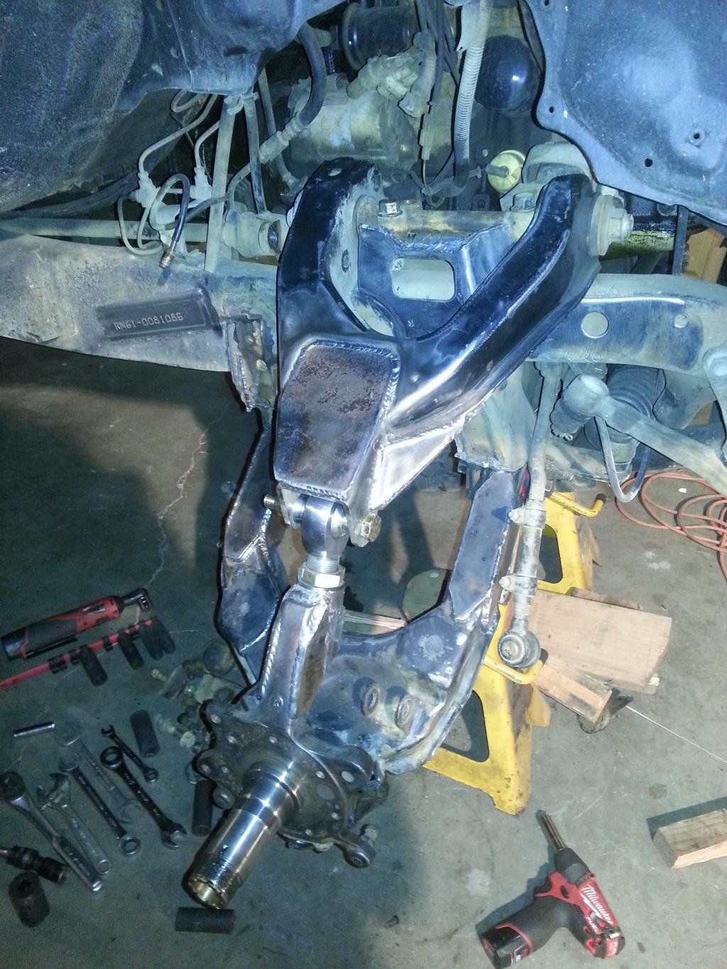

So I got the passenger side a arms and spindle done.
4.5" wide per side
Sfa hubs which bring my wms back in 1.25" so my overall track width change is 6.5" overall
12.5° kpi/sai
7.5° caster
Camber at full drop 3.5°
Camber at full bump 4.5°
17" travel metal to metal
Bumped and strapped a 14.5"
Also moved the spindle 1" forward
Size:  218.7 KBName:  20150226_210847_zpsoudvxi4t.jpg
