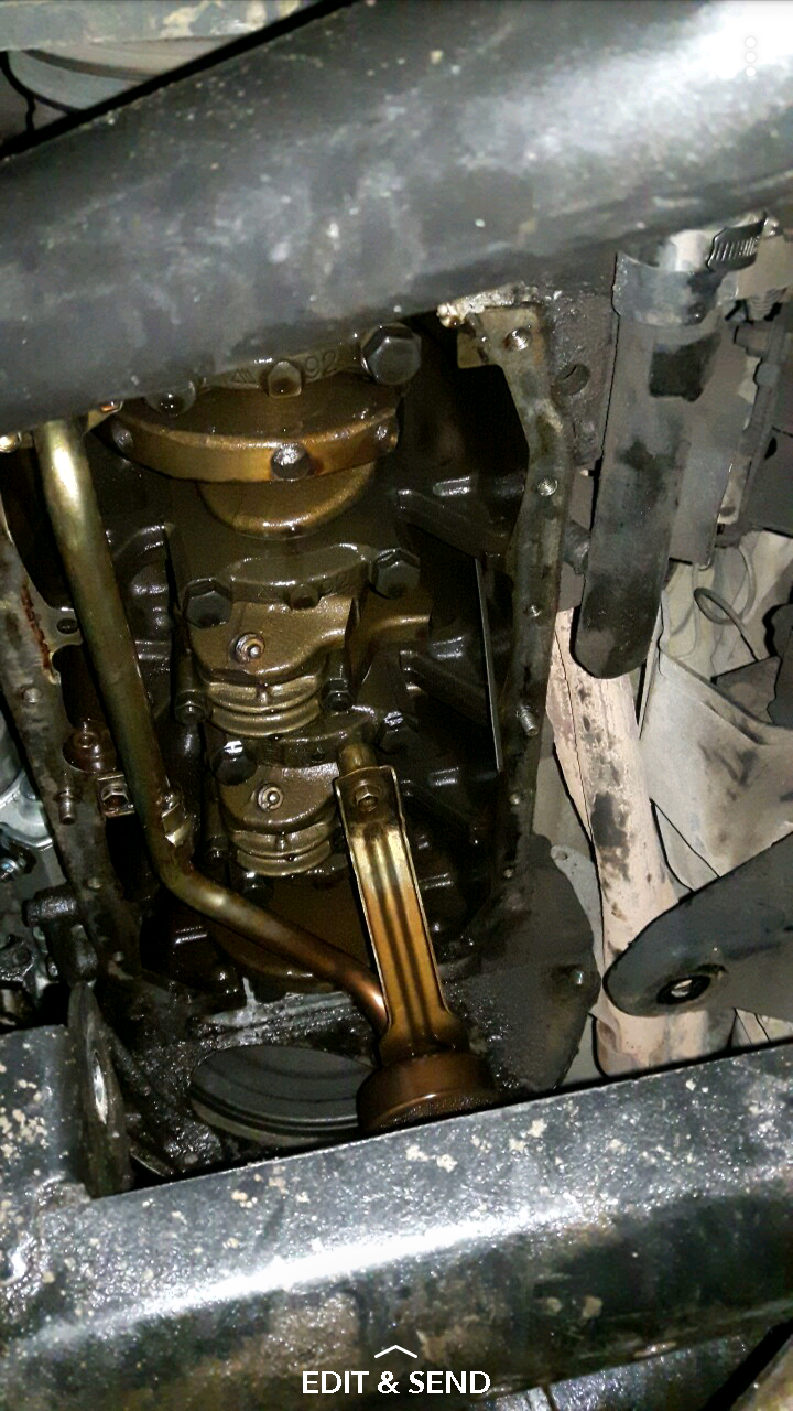

How's it going everyone, So I bought an 86 toyota pickup 22r 4wd with 135000 miles well that is what the dash says!Haha I got it about 3 weeks ago any ways I got the truck for 1800 with some fixing needed to it, when I first got it it has a real bad oil pan leak that I fixed 3 days ago and now seems to not have any leaks anymore! But I got this truck so I could slowly work on it
Before the the repair
After the repair

Did it clear the front dif/axle or did you have to move things around?

no I had to unbolt the 2 main diff supports and loosening the front pivot mount, and also removed the steering stabilizer, took me about 8 hours to do everything it was my first time doing this.

I would take a peak at the timing chain guides as well. Drivers side timing guide is known for braking into pieces. Remove valve cover and shine a light down at the timing chain. Was there any debris in the oil pan?

yeah we did take a look in there everything looked good, and no nothing in the oil pan at all just a little dirt.
