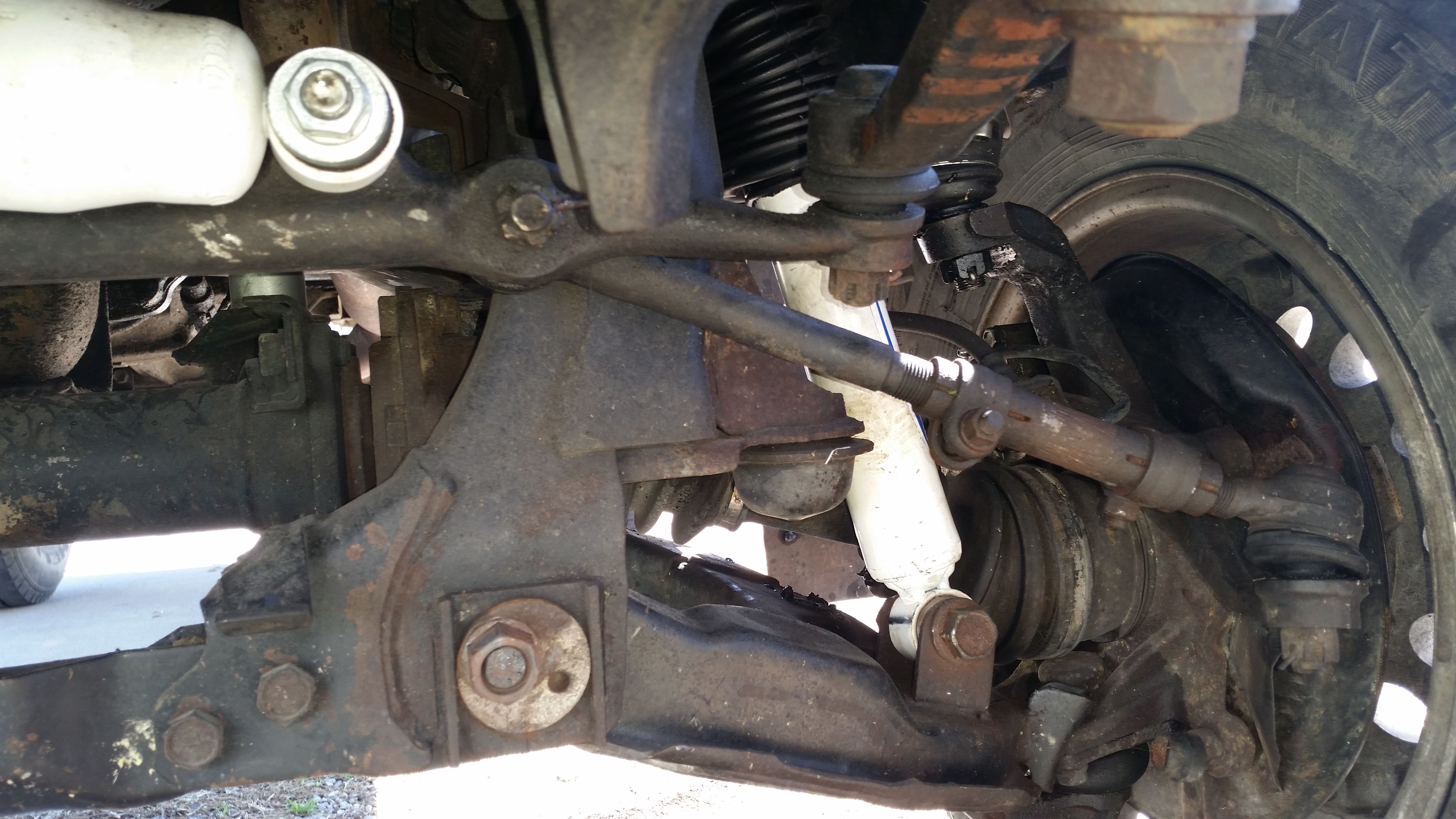

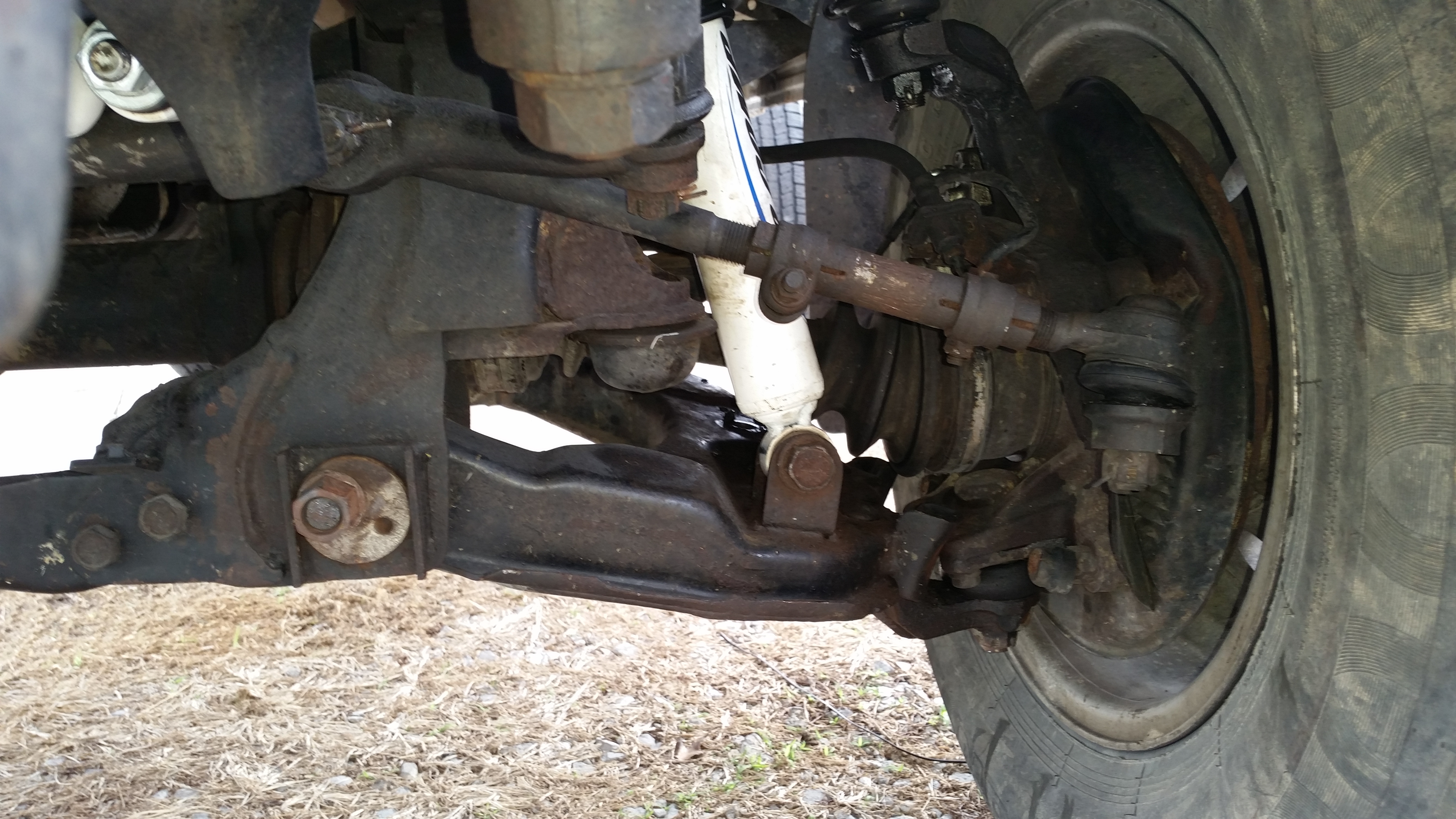

Here are my tierods coming down. They are pretty steep, but is that enough to make it unstable?

Looks to me like way too much lift for IFS. You're going to eat CV shafts left and right. You don't want more than 20 - 22* on running angle of CV shafts. I bet you do have steering problems, geometry looks terrible. Relax torsion bars and just run ball joint spacers. Or figure a way to drop both pitman and idler arms. Maybe the guys that run bracket lifts have another solution for steering geometry.

I am going to guess that some of the issue is that there is very little droop left in that suspension with the bars cranked all the way up
So the "bump steer" is actually "tires not in contact with the road" as there is no "droop" left.
Cut the bolts (or if you are lucky - crank em down) back to stock, re align and then see where things stand.

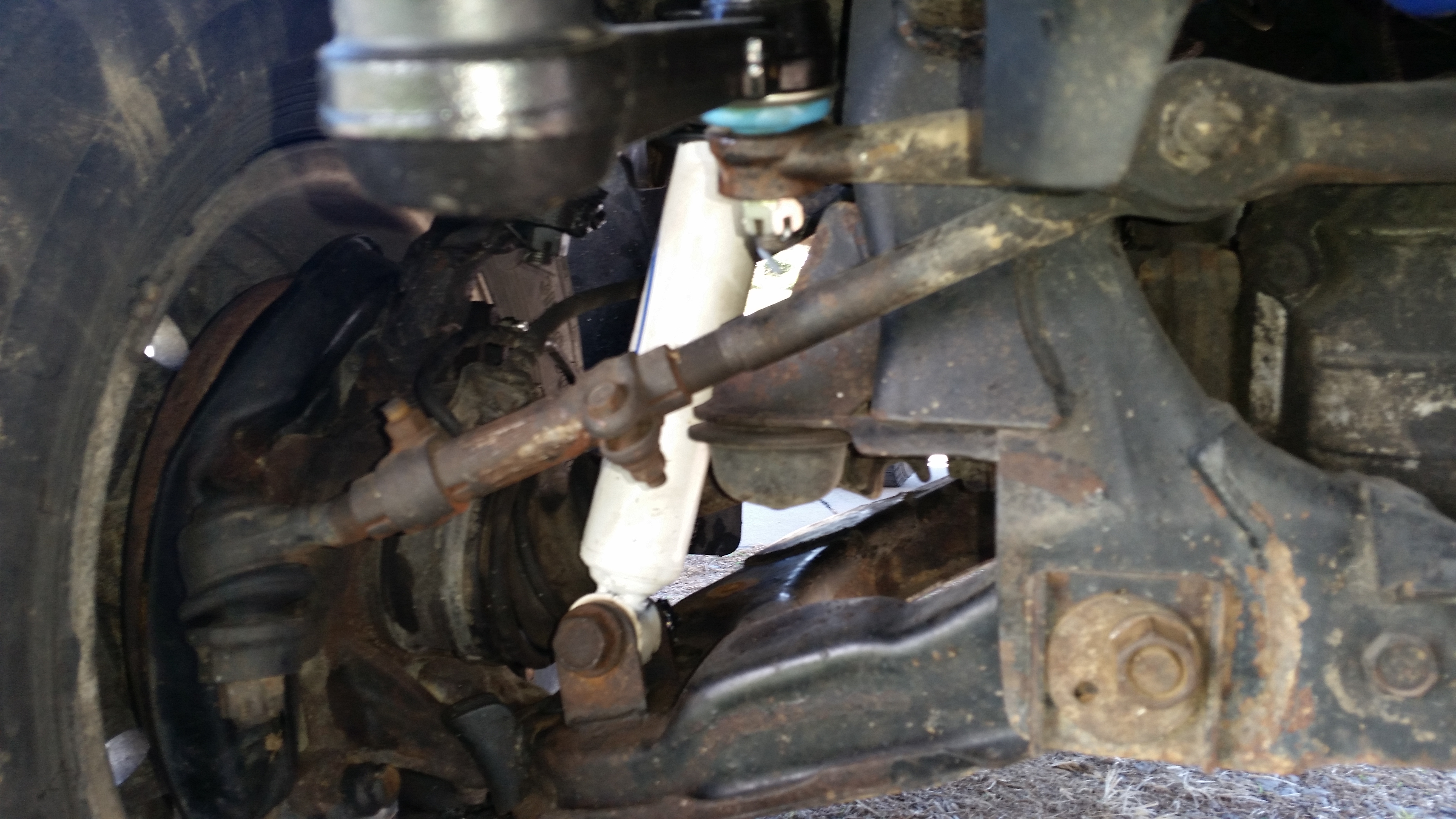

I lowered the front end back down. It took 10 turns on the passenger side and 14 turns on the driver side to lower it back down 1 1/4 inches. All the problems at lower speeds are taken care of. At high speeds it still wants to wander some, but not as much. I'll get new tires in a couple months and have it aligned again after that and see if it gets all the way better. The angle on the tie rods looks considerably smaller now.
