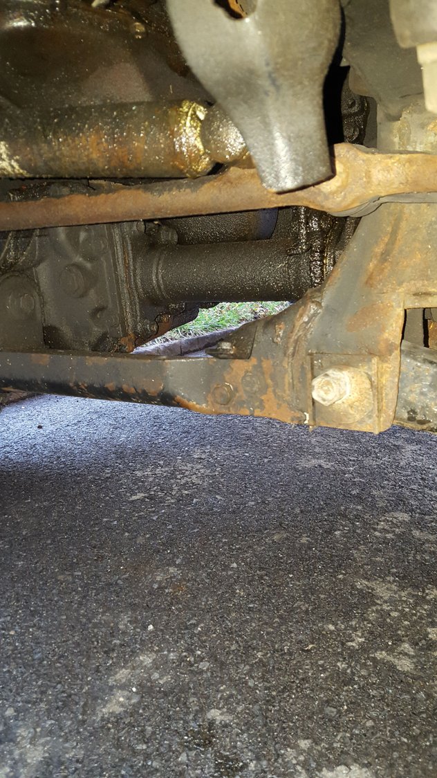

Old Dec 17, 2015 | 12:11 PM
86toyoturbo's Avatar
Joined: Dec 2015
Posts: 10
Is that what you are talking about?
Old Dec 17, 2015 | 12:31 PM
RJR's Avatar
RJR
Joined: Jul 2012
Posts: 1,776
Likes: 110
From: Northern Colorado
Can't see enough of it to be absolutely sure, but from what I can see you don't have the ADD system. If you had ADD the extension would be bigger, have a side cover on it, and two vacuum and one electrical connector.
