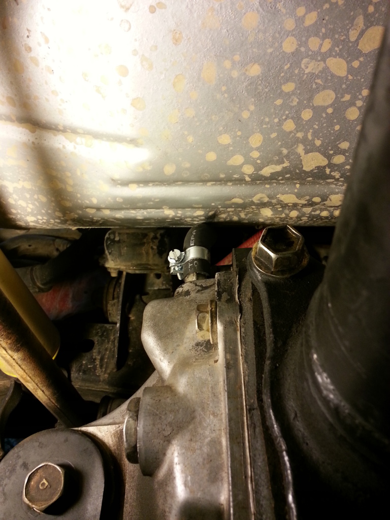

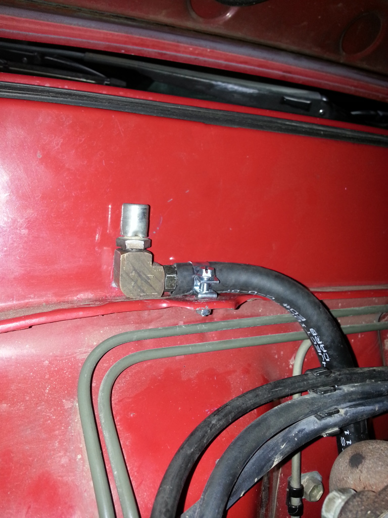

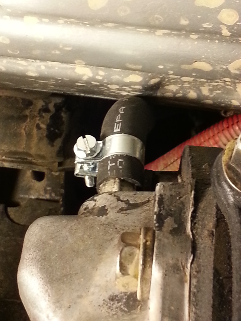

ChefYota4x4's Avatar
iTrader: (5)
Posts: 19,281
Likes: 20
From: Lake Havasu, AZ
Hey girl! Well now, from what ur saying, it seems like u might be ok? GOSH I hope so, for ur sake! That wud be great.
Funny u mention diff breathers. .. Just did my front tonight ....... >>>
For the rear diff extension, I'll be using tje brake light body cavity.
If u pulled in water, into the diff... drain that quick.... very bad combo in there.
Best wishes with everything

infinityisfive's Avatar
Joined: Feb 2010
Posts: 54
From: Connecticut
It's very much most likely this. There are lots of threads about diff breather extenders but few on transmission/trans case breather extenders. One thing people do is run the breather up the gap between the cab and bed.. if you have a 4runner you're up a creek though (lul). Definitely do a new main seal just for kicks and you should be good. If it IS the A340 (sounds like it) it's a very over-engineered transmission and the best auto you can get.. they're still using them in new tundras. And you could always throw a ford explorer trans cooler on it.
