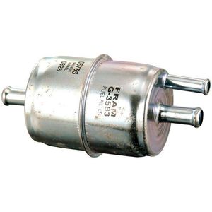

I have a fuel filter that I use that has the return line
Before that I just capped the return line. You will want to get a fuel pressure regulator as well. The Weber needs 2-3 psi to perform at it's best. In order to get the fuel economy equal to stock and maybe up the performance you will also want a jet kit. A high altitude jet kit if you are above 4000ft. Once you have jets you can tune that shiz in like 30 minutes on the fly.
