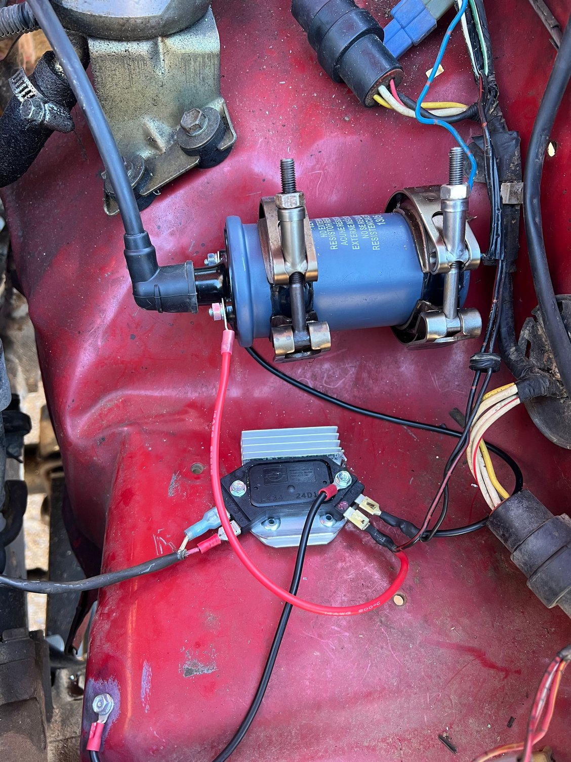

currently have a 86 pick up with 22R that’s been bored .40 over, deck skimmed, head built and skimmed, bigger valves and springs, GM ignition conversion (Delphi DS ignition module and GM coil), 5 psi fuel pump with filter, Weber 38. i’ve been having problems with random ignition loss and i found a thread by a username of “irv” that suggested the Delphi module. installed today and vehicle runs great and idles fine but dies after throttle input (basically on decceraltion). it doesn’t seem like the throttle plate is closing all the way starving it for air, but it burps from the carb when it dies. any ideas or similar problems?

i honestly think it’s the cheap distributor from autozone i bought. i have the canister style SMP ignition coil, redid the air gap on magnet in the cap, changed plugs for NGK and they weren’t fouled, and cleaned carb. i did all of that this morning and still the same results. i think im going to buy the ProDistributor from LCE and try it. i really appreciate all the help dude. the facebook and reddit groups do not help at all.

From the pics it looks like you have the SMP UC-15 coil, which is good. NGK plugs are excellent. Great on the fuel pressure regulator.
