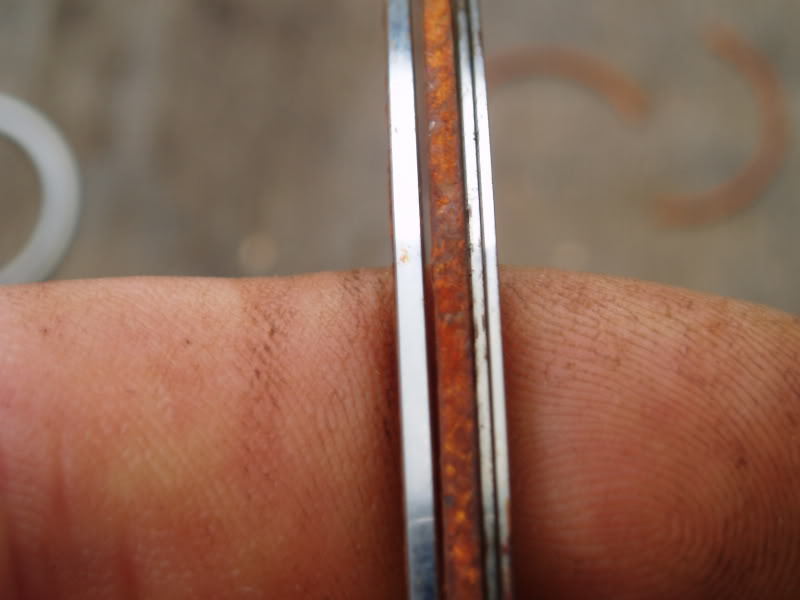

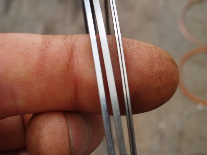

TAE? Don't know. I'll show you some pics of how I found out chrome or no chrome. No, shiny doesn't necessarily mean chrome. You'll see.
BTW, What do you mean by "good online source of OEM rings"? Cheap, or OEM manufacturer ONLY?
Originally Posted by gbwsaw28
I still haven't found exactly what Toyota originally used! that would be nice info... anyone got pics of their original rings?
If you've studied my previous post then you'll see the reasoning behind believing that the rings used for the 22RE and the 3VZE are the same basic type/design. So these pics are of the OEM rings from my 88 3VZE. They were on OEM pistons, so I believe they were the originals from the factory. Arranged top-to-bottom as they should be. I left some outside in the rain to rust up. The ones left inside, still coated in motor oil, stayed rust free.
My Conclusion: They were probably nearly the same as the NPR rings I replaced them with. Steel chrome faced(? plated)#1 ring, Cast Iron(? plated)#2 ring, Nifflex-S 3 piece, chrome faced oil control rings. #1 ring and oil control rings sounded like steel when dropped, #2 makes a thud like cast iron. All shiny faced(indicative of chrome)when removed, and stayed so all except the cast iron #2 in the bottom pic. OEM rings then?...looks like a duck...quacks like a duck...They could be, or they could be OEM type. They weren't marked, other than "1R" and "2R" on the rings topsides. Which, IIRC, was the same for the NPR rings.
Uncorroded set.
Corroded set. The difference there is obvious. WAY less rust on the chrome faces vs. the cast iron.
