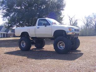

Trying to post a pic.
Attached Thumbnails 70 1/2" drive shaft?-91-001.jpg

most people here will say that its too high... i disagree, that is a sexy truck. I wouldnt take it crawling though

Damn!! That's a big Toy!

Its defiantly a mud truck.
A once piece shaft should work fine.
...you dont have blocks in the front do you?

They are called sliders... not step ladders
Still, they don't look that bad up that high. I just can't believe that a little 22re will actually power that thing.

It doesn't have blocks up front and the 94 its going under has a built v6. The built 22re that was in it pulled it very good but im hoping to get more from the 6.

you're replacing the 22re with a 3VZFE? epic fail.
drop in a chevy 4.3l vortec. they fit better than the 3.0, and loads of power
