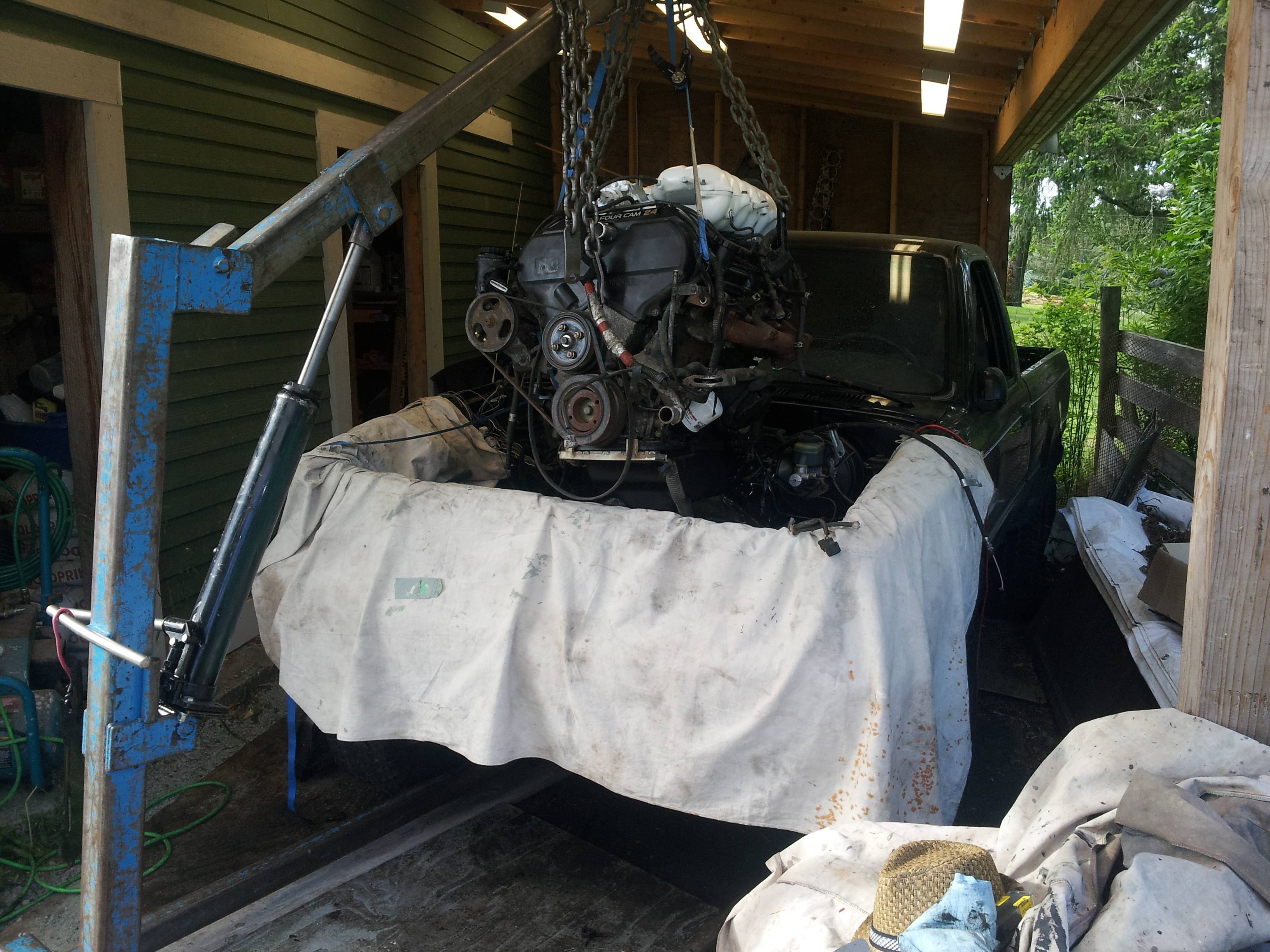

Starts up no problem; revs great, but once it wants come to an idle it runs rich and just drops off.
Seems like it's not picking up the airflow sensor (cause it acts the same if it's unplugged) but i've got power and continuity to it.
Well whatever it is; it seems like and emergency shut down of sorts; so i'm sort of at a loss for where to start looking!
Any suggestions at all would be amazing! thanks in advance
As per usual, pics for advice!

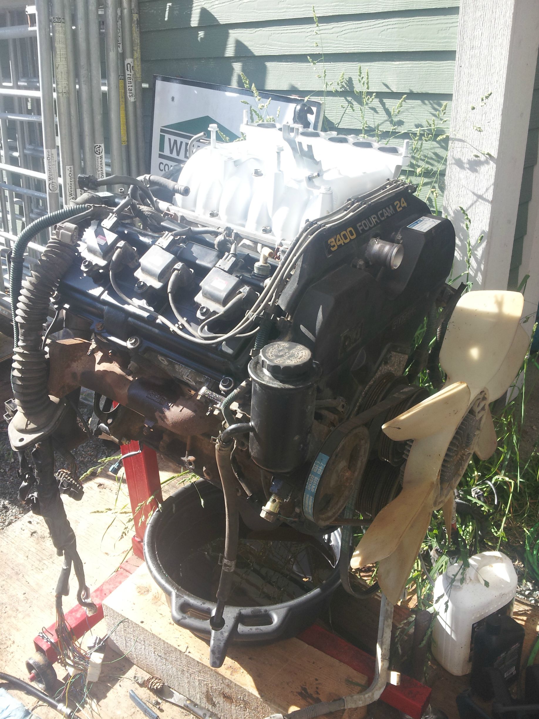

lol fair enough, any idea what kind of wiring mix up could cause this? EDIT: Let it run as well as not letting the smoke out?

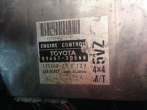

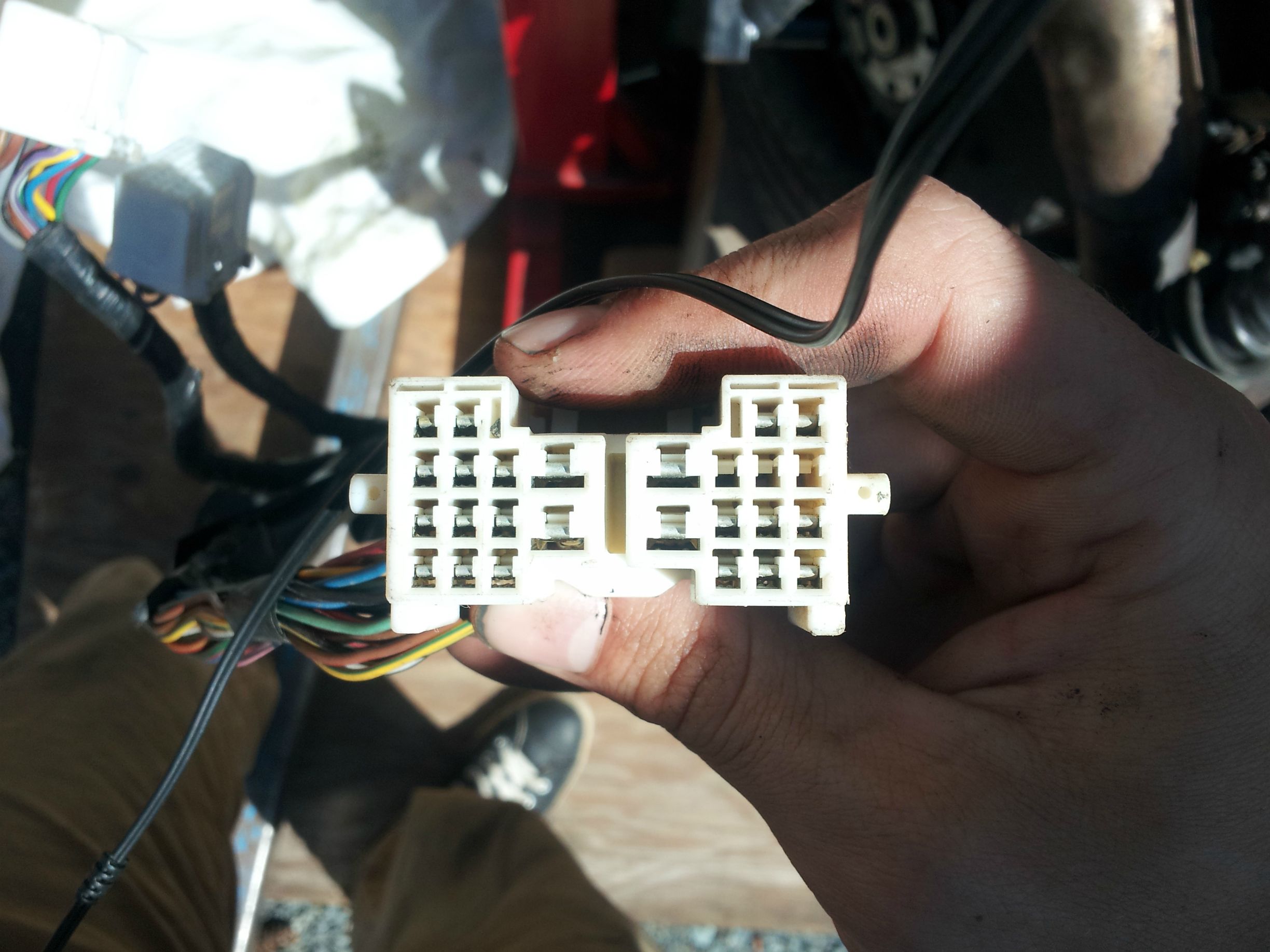

So Quick question, this is what i have as far as ECU plugs \/\/\/\/
\/not my pic but basically this\/

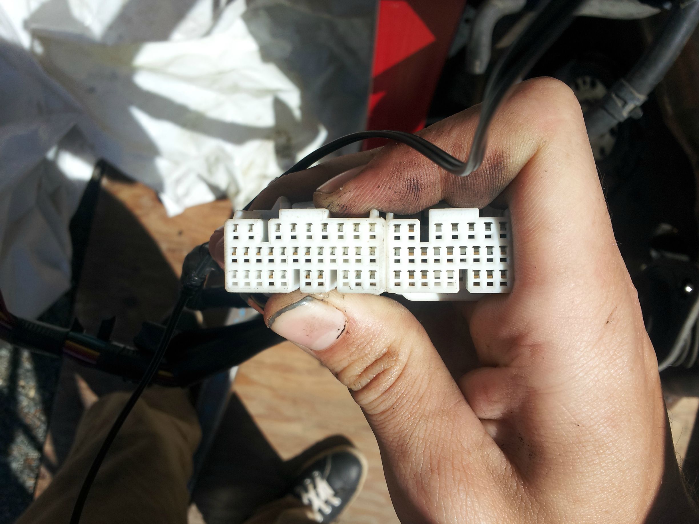

But this is more what i've been finding they SHOULD look like \/\/\/\/
soooo what year ECU do i actually have? It's suppose to be a 98'..... starting to look like its not though....

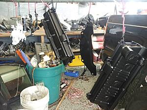

Yeah I called the wreckers i picked the engine up at, and they still think it's a 98'. I'm confidant it isn't...
So i'm gonna run to the shop it's parked at and grab those numbers tomorrow morning.
I'm hoping the shop can pull the ECU diagrams too while i'm there.

plugs and pins don't mean anything , as long as it is matched to your harness .. for example
/99 Tacoma and /99 4runner computers are completely different , and one looks like the pic you posted , and the other looks like the other pic you posted .
I would assume this problem exists in your wiring
Old 07-23-2014, 05:02 PM
Seatbelts's Avatar
Join Date: Feb 2014
Posts: 39
Received 0 Likes on 0 Posts
The problem is obviously wiring.
It's not about the pins or the plugs;
the problem is that the plugs i posted don't match up to the 98' 4Runner's plugs on the diagrams, that style of plug seems to be mostly found post 2000.
(The ECU pic's aren't of mine)

The second ECU picture is this:
http://www.toyotapartszone.com/oem/t...661-04450.html
Is there a five digit number stamped on each of those plugs you are holding? If so, what are they?
Is everything installed on the engine i.e. intake tube, O2 sensors, etc. before you are trying to run it?
What wiring did you do between the engine and ECU? What ECU is in it?

Sorry i guess i wasn't very clear, The engine is completely installed; the engine+ECU are a pair and came together, no wiring done in between there.
I'm trying to wire the engine harness from the 5VZ into the main harness on my 94' pickup
From This \/\/\/
To These \/\/\/

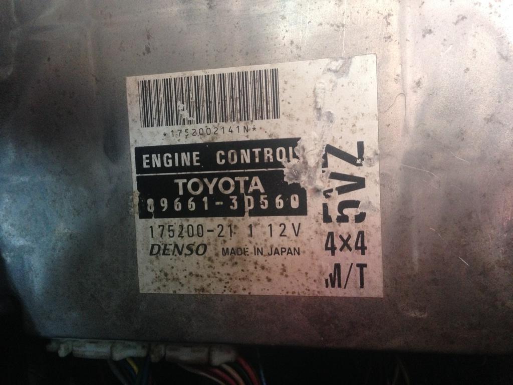

Ok so; got the numbers from the ECU
and ebay tells me it's a 00' which makes sense but now i need some new wiring diagrams,
anyone got anything on hand? save me the 2 days subscription on TIS?
