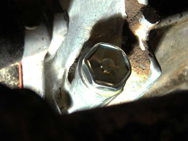

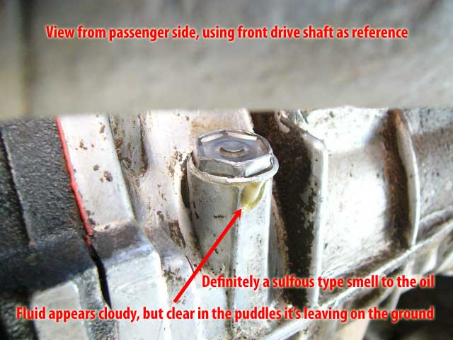

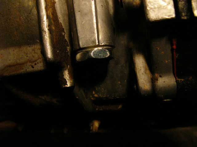

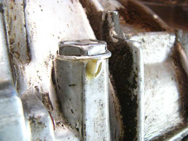

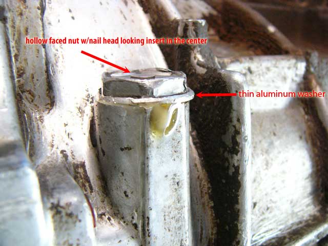

I have a 1989 4Runner w/the 3.0 V6 running a manual 5-speed transmission. I've got a substantial leak coming from a strange looking hollow-faced bolt with what looks like a nail-head that appears to be overly tight against a thin aluminum washer at an inlet on the passenger side of the transmission.
My first question is what's this fluid?
Next, how do I stop it from draining out and ruining my transmission?
Most important, what do I need to do to actually fix it?
I have taken some pics so you guys can take a look.
Please help!
Attached Thumbnails 5-Speed Manual Trans Leaking Fluid - Need Advice - Pics Included-leak01.jpg   5-Speed Manual Trans Leaking Fluid - Need Advice - Pics Included-leak00.jpg   5-Speed Manual Trans Leaking Fluid - Need Advice - Pics Included-leak02.gif

Go get 2 new bolts, drain and fill, take off the fill bolt, then take off the drain bolt, drain the fluid, put new bolts and washers on, fill it back up, done.
I think all the bolts are supposed to look like that...i could be wrong tho
https://www.yotatech.com/51214405-post34.html. that was mine...

is the bolt in the pics the drain or the fill bolt?
more importantly, where's the other bolt that needs to come off going to be located?
and...
anybody know the size of the bolts and washers needed? my toyota dealer never seems to be able to get me anything without part numbers/numbers...
I'm worried about driving it low on fluid, it's lost a decent sized puddle over the pasty few days...is it reasonably safe to drive to the dealership or parts store or would that be like driving an engine without enough oil or coolant? I don't want to blow out the transmission when the fix seems to be a pretty straight forward procedure.

That was the fill. When i got my new fill bolt from toyota i just said "i need a transmission fill bolt for a 94 4 runner 5spd" and he got one for me. Ill see if i can find the part number for ya in my box o truck papers.
The fill is on the driver side up a little higher.

Pretty sure the fill is on the drivers side, a little higher up on the trans.. or i might be trippin'

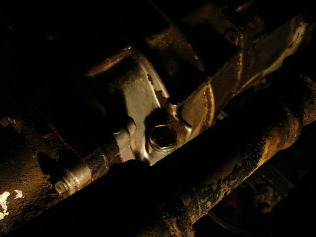

so this is the drain hole bolt...it's located near the bottom of the transmission, oil leaking...ok, makes sense.
found the fill bolt/hole about halfway up and a couple inches forward on the driver side.
both bolts appear to have decent faces, so I should be able to get them off pretty easily.
while I don't think the transmission needs new fluid, I figure I'll drain it and replace with fresh gear oil just the same. The FSM calls for 3.2 quarts of SAE 75W-90, so that's what I'll be using.

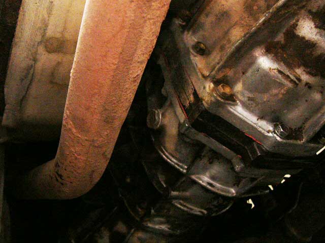

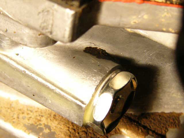

Took the truck home last night, snapped a couple pics of the work to post up here on the site...take a closer look and can see that the washer is in crooked...on side is pushed in further than the other by about half the washers thickness.
I go back to the Toyota dealership this afternoon around 2pm...at 6pm, they come tell me that the transmission case is cracked, they can't supply one because they are no longer made and if I go to a junkyard and get a new case they'll put it in for $850.
WTF!
Now, mind you, they delivered the vehicle to me the night before and all was well. No issues with the bolts, washers or any crack in the case. They even tried to sell me the trim fasteners for the side air vents...not a word that anything had been or gone wrong.
So I go out to the truck, look at it on the rack (after sitting in the waiting room for 4hrs)...the mechanic shows me the "crack" at an angle I can't really see from...so with his light I look around from the side I took the pictures you see in my original post...only now I see a crack running from the edge of the face of the washer all the way out and through the outer face of the transmission housing about a 1/4".
I tell the guy, there was no crack there when I brought this in yesterday and you're the only ones to have touched the truck since. The guy is looking nervous at this point. He tells me he's been doing this for 10yrs and would only tighten the drain plug to 12lbs of torque per the Toyota specs.
What the mechanic does not know is that I took pics of newly installed bolts last night to post here on the site. There was no crack as of last night, I have the before the transmission service, after the transmission service and now the second transmission service/cracked transmission case....pics to prove it.
Not only was there no crack, but I took the pics to show how the dealer installed the drain plug washer crooked...they show the crooked washer and the leak even worse than before I took it in.

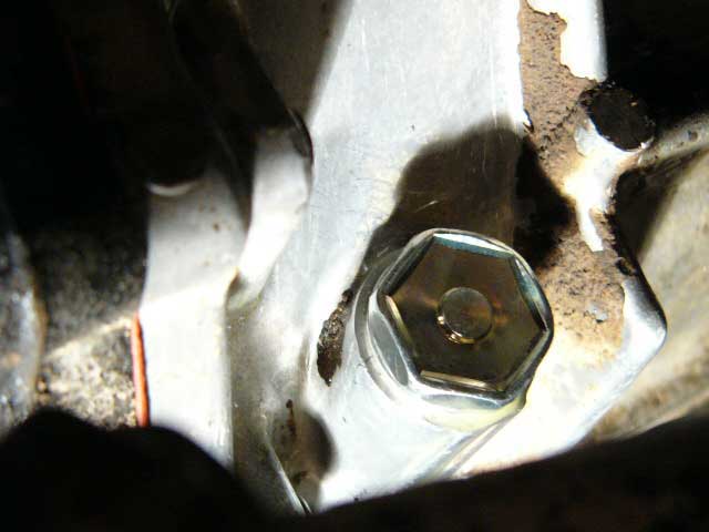

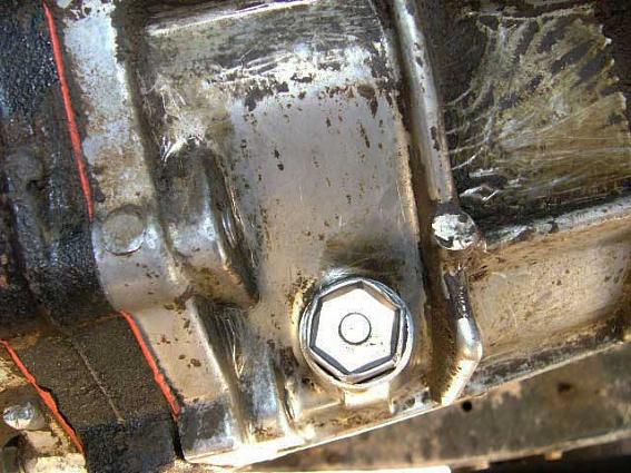

Before
Attached Thumbnails 5-Speed Manual Trans Leaking Fluid - Need Advice - Pics Included-110809a.jpg   5-Speed Manual Trans Leaking Fluid - Need Advice - Pics Included-110809b.jpg   5-Speed Manual Trans Leaking Fluid - Need Advice - Pics Included-110809c.jpg

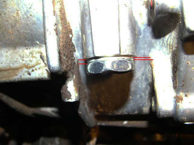

After Transmission Service - note the third pic, the washer is clearly slanted
Attached Thumbnails 5-Speed Manual Trans Leaking Fluid - Need Advice - Pics Included-111009a.jpg   5-Speed Manual Trans Leaking Fluid - Need Advice - Pics Included-111009b.jpg   5-Speed Manual Trans Leaking Fluid - Need Advice - Pics Included-111009c.jpg

After Second Service, Cracked Transmission Case
Attached Thumbnails 5-Speed Manual Trans Leaking Fluid - Need Advice - Pics Included-111109a.jpg   5-Speed Manual Trans Leaking Fluid - Need Advice - Pics Included-111109b.jpg   5-Speed Manual Trans Leaking Fluid - Need Advice - Pics Included-111109c.jpg
