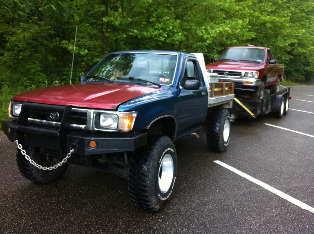

Yep sure will

I only own to trucks ones a 87 other is 93. I tow with both of them. Here's what I did to upgrade my towing limits.
Eliminated the LSPV (50/50 brakes)
4.88 gears
Heavy duty hitch (bolts to sides and bottom of frame)
Trailer wiring and electronic brakes controller
I will soon add one extra leaf just for caring capacity. My trailer is about 7' wide and 16' long. It's weight is around 1,000 maybe more. I can and have hauled over 2 ton on it and pulled it with my 93 toyota. The one pictured. So I can say that I have pulled over 2.5 ton with my truck with ease. That includes some highway traveling. I can cruise at 70 MPH or 80 if I want. Now on steep grades I sometimes have to down shift to 4th or 3rd depending on my speed. Keep in mind that my 93 is a 22re and my 87 is a 22R. Both tow extremely well IMO. Now I've never owned anything larger then a Dodge Dakota which is really a mid size truck. So I'm saying mine tows great however someone use to a full size my say it tows like ˟˟˟˟.

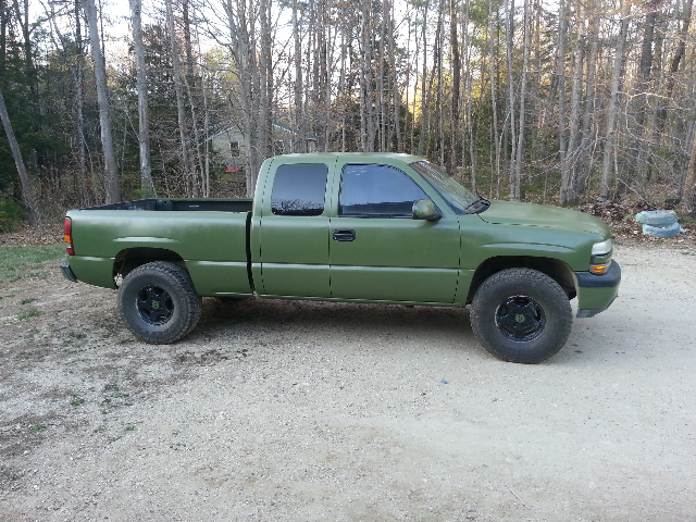

I have owned multiple toyotas and bought the silverado to tow my cruiser but sold cruiser. Now im getting my toyotas back. While i like the silverado its doesnt motivate me like the yotas always have.
Attached Thumbnails 4runner towing capabilities???-forumrunner_20130630_001154.png
