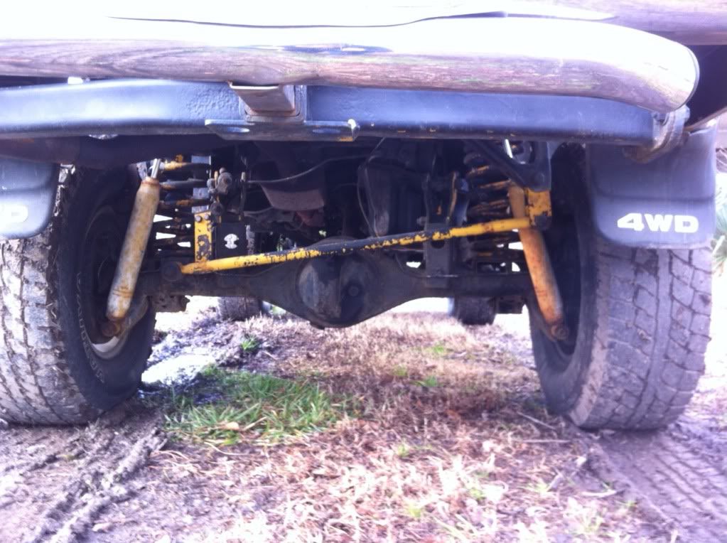

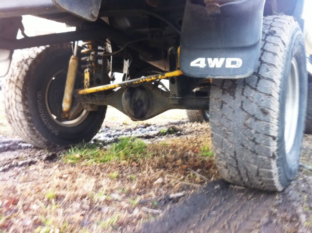

So, I would first like to say, great post with really good photos. I have been searching all over trying to find something that closely matches my rear axle; I am sure there is a place to post questions like this, and I know it's something I SHOULD know about, but I'm still learning as I go when it comes to this stuff. So, Don't mean to post in the wrong place if I am. But, here it goes:
Couple questions. 1) What does this cross bar do? Like, what's the point of installing one? and 2) Is it supposed to be level with the axle??? I have this same set-up installed, but the bar is WAY angled. I'll throw a photo up right after this post. I am trying to figure out what's going on here so I can prep to pull the body lift off this thing, I don't want to have to put 35's or 37's on it for it not to look all crazy. This is a lot of lift. Tires are expensive!!! I'd much rather a 4" suspension (pull the 3" body lift off) and a set of 32" or 33" tires. Getting off topis, sorry.....
So, what's the point of this bar and why is mine not level I suppose is what I need to know here. Photo to follow, thanks in advance for the info. I know it's probably a dumb question. Sorry! gotta start learning somewhere, right??? Thanks again!

Note the extremely not straight angle of that bar?
I had my girlfriend take these this morning, I just picked this thing up last night, so I am going to take more photos this afternoon, clean the interior up all shiny and clean. . . . start plotting how to get this 3" body lift on so I can put tires on it that don't cost $200+ a pop. Anyways. . . any knowledge you can share about this would be great. Thank you!!!!

The track bar works with the control arms to locate your axle. Because one side attaches to the axle and the other side to the frame, your axle will move a little side to side (on the arc of the track bar) as it moves up and down. That side to side movement is minimized when the track bar starts in a horizontal position. In your case, unless that track bar has been lengthened, it's already pulling the entire axle towards the passenger side a bit, which is putting undesigned-for stresses on your driveline and control arms. Worse, as the drivers side suspension unloads and moves that side of axle away (down) from the truck, the track bar is going to pull the entire axle even farther off center.
I don't know exactly how bad that is, but it certainly isn't good.

Well, being that high up, I am going to guess that if it were pulling the axle it would be noticable wouldn't it??? Can I just straight pull this bar off or would there be some adverse effect?

It's also what keeps your axle from shifting side to side when you corner. The control arms are not angled properly to keep the axle from shifting themselves, so don't remove it!

OK, so after doing some research, I have reached the following, can you guys tell me whether I am off base here???
The bar CAN be at an angle, as it is in my 4runner. It DOES however have to be the right length to accomodate the angle..... vs. being exactly horizontal.
The rear axle gear grinding thing is apparently a bushing. The guy tried to re-gear it, never finished the process, put the stock gears back in it, but screwed something up and now there is a bad bearing....
As you can see, I don't know a whole lot, but as I said, I'm trying to learn as I go. Hopefully I don't have to learn the hard way with all this stuff. I am going to stop by a shop on the way home and see what they say about it. Maybe I'll luck out and it's not such a big deal. so I can hope. . . . . . . . . .
