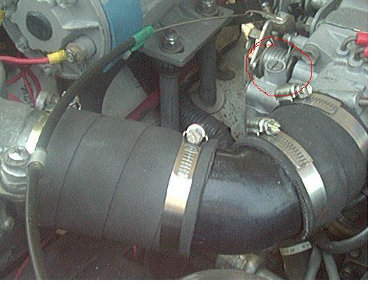

The idle IS set too high. If it wasn't dark out I would go out to the driveway with my phone camcorder, turn the idle up, depress the brake pedal and duplicate the exact problem being described. With only the change in my pocket. And then post it of course.

I drove it home for him but i cant remember exactly where the rpms were. I'm not forsure but it might have been dropping to 1000 and raising to 1300 but like i say i cant really remember. I'll find out tomorrow.

Having to turn down the idle? Why? Why was it too high to begin with? Let me guess, somebody got in there and turned it up when you weren't looking right?
As I've said, if the idle is too high you've got a vacuum leak somewhere that caused it. Problem solved addressing it by turning the idle down? NONE!
It might work to temporarily solve some peculiar symptom. DOESN'T FIX THE VACUUM LEAK THOUGH DOES IT!

Now having said that I do understand that your vacuum leak argument does have merit although in this instance I firmly believe it's the idle that is out, not a vacuum issue and not caused by a vacuum issue.
I guess we'll just have to wait and see. If you're right then I'll give you the due credit.

I actually just fixed this problem on my truck. Malfunctioning idle air control valve was causing the idle to be too high. Idle control screw on throttle body would bottom out before the idle to would go low enough so after a painstaking amount of troubleshooting and research I narrowed it down to the culprit. Problem solved. Idle was too high.
