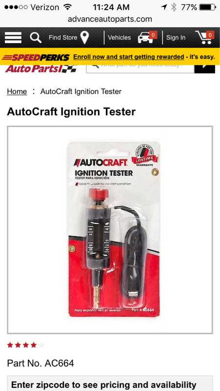

You can also check your spark with a tester.
You can adjust the pin out until you lose spark to determine the voltage your ignition system is putting out, then compare that tithe service range in the FSM.
