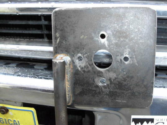

The crankshaft pulley bolt can be a bear to remove from most Toyota engines to get at the front oil seal, timing cover and oil pump. I finally had an SST made at a local weld/machine shop for $35.00. It works great. Pictures below. A few years ago I replaced the front seal when
I had the cylinder head off to have it reconditioned. At the time I rented a ¾” electric impact wrench for about $15.00 a day. It got the job done. I had tried to get the bolt out by hand to no avail. In the last couple of years the front seal started leaking again. It kept getting worse. Two months ago I tore the truck1988 sr5 4x4 down to replace the seal. Taking it to the shop was not an option. I am disabled from a stroke and a poor man. Even though I have almost no use of my left hand (I was a lefty) I still work on my truck one handed. Even though I live in Knoxville, TN a town of 200,000, I found an electric impact wrench was no longer available to rent. I called every rental store in town. Finally after 4 days I gave up and put it back together. The leak got worse until I was losing a quart every 100 miles. Me truck has over 250,000 miles on it. A week ago my son, who lives here now helped my tear it down to try again. Here is what we tried to remove the stubborn bolt:
Bump starter trick- 18” breaker bar wedged on frame rail. No go. Battery was fully charged.
Cheater bar-(4.5 feet long floor jack handle over breaker bar).No go.
Cheater bar-(4.5 feet long floor jack handle over breaker bar).Wheel chocked. Tranny in 4x4 low. No go.
Cheater bar-(4.5 feet long floor jack handle over breaker bar). I stood on brake while my 24 year old son (strong as a bull) turned bolt. Nope.
Cheater bar-(4.5 feet long floor jack handle over breaker bar). Wedged short ¾” bar of cold rolled steel in driveline. No go. It was apparent my high mileage engine did not have enough compression to resist turning long enough to break bolt loose. I made a drawing to took it to a local shop I have used before. Here it is: Of course, the exact design will have to be customized to the vehicle. The bar is 3/4 cold rolled steel. Very unlikely to bend. I used 1-3/8" socket head bolts to fasten the plate to the pulley. Make sure to make the center hole big enough to allow for the thickness of the socket. That's it. Bar hit ground and keeps pulley from turning.

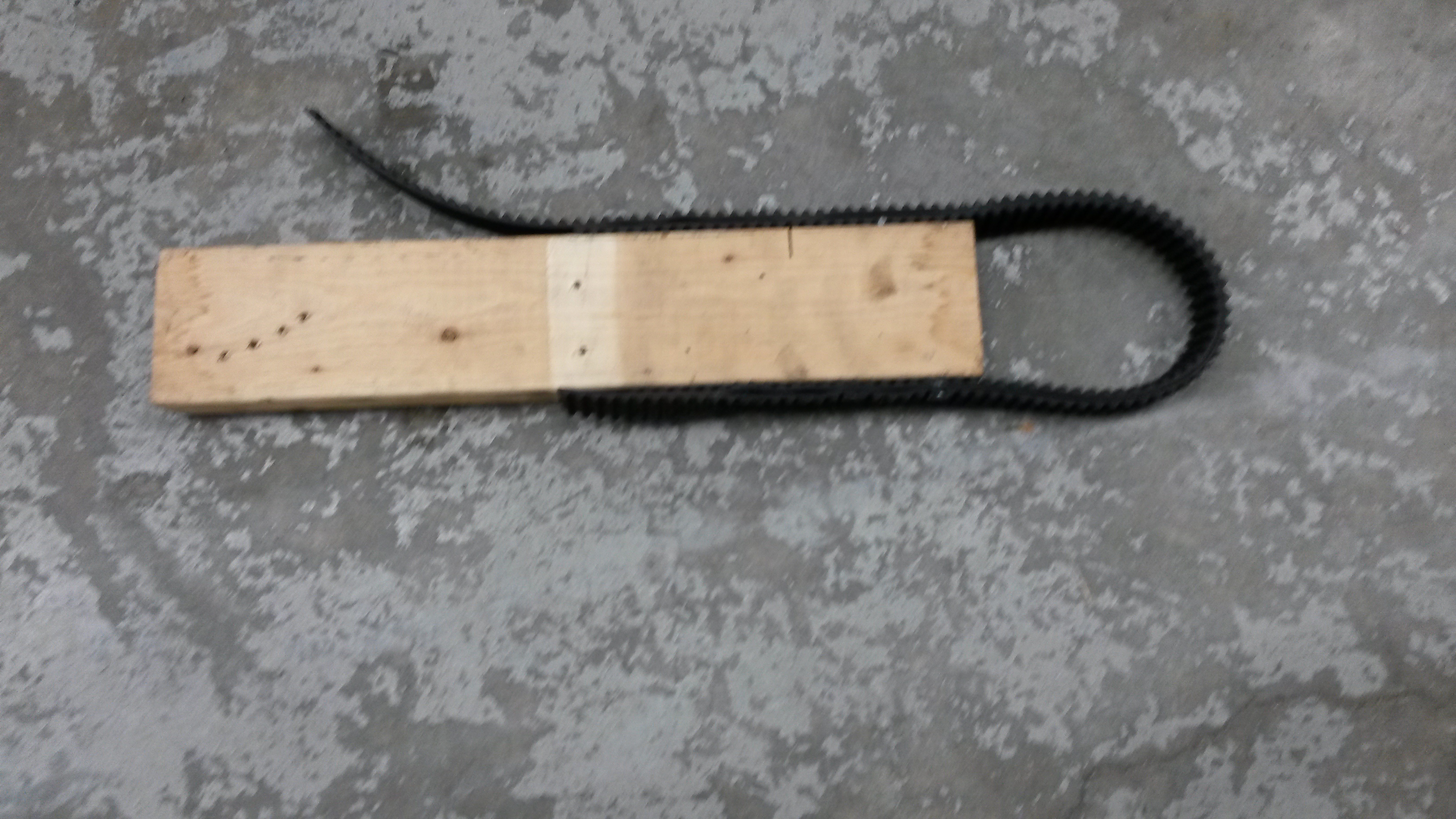

This is the simple tool i made to remove the cam sprocket bolts on my 4runner. Just a 2 foot long piece of 2x4 with a cut up timing belt screwed to the end. I didn't have an old one laying around so I had to suck it up and buy a new one from autozone. $19.99+ tax.
I first put the end of the 2x4 against the sprocket.
Wrapped the belt around the sprocket to get the correct length.
Then cut it into 2 pieces. So I could double up the belt. Makes it stronger.
Then ran a crap load of screws through the belt, along the edge of the 2x4.
Worked like a dream. Check out the pictures for a better idea of what I did.
Where's the pictures? No see 'em.

Hm. They didn't upload. I'll try again.
Attached Thumbnails 3VZE timing belt pulley removal tool SST?-20141206_152038.jpg   3VZE timing belt pulley removal tool SST?-20141206_113339.jpg

How did you slip it over the cam pulley on the other side that has the rim to the outside?
I actually use a very similar home-made tool for holding flywheels on small engines.

After i put that "tool" in there, I used a breaker bar with a 4' long piece of chain link fence post as a cheater and it broke the bolts loose with very little effort.

Removed the screws from one side of the 2x4, wrapped the belt around the sprocket, then screwed them back in. After i broke the first bolt loose, I didn't completely remove it. That way I could use it for a brace for the other sprocket.
