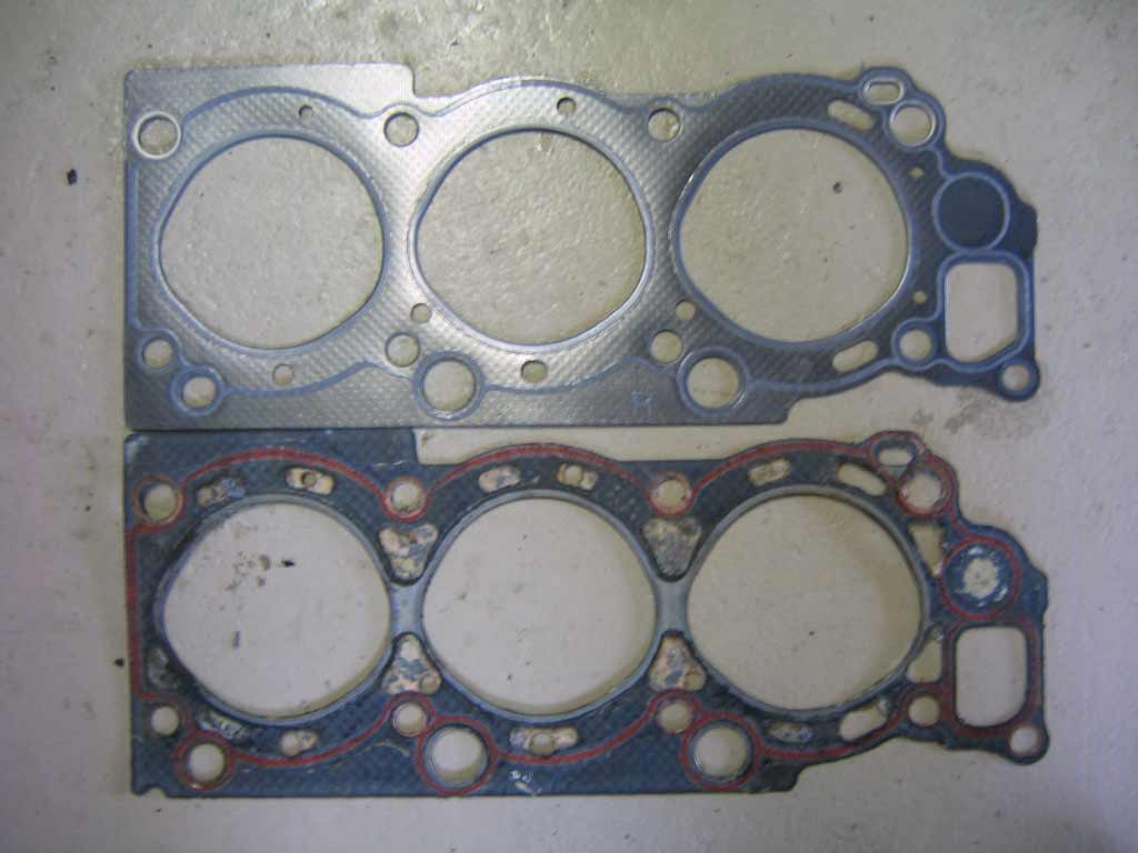

not bad for a 3.0 thats for sure. It's not because of the crossover exhaust that made it blow. Its just the design of the block and gaskets. They usually blow on cyls 1 & 6 which are the same. You could swap both heads on either side and all the passages would line up, but you don't wanna do that. Just saying they are the same and thats why cyls 1 and 6 blow
Here are pix of my old gaskets and new toyota gaskets side by side iIdo not know what manufature made the old ones as they were put on by a bad mechainc who sold me a crappy rebuild two years ago. I am about to put new heads on mine after they blew. Looks like he put used un prepped and machined heads on my truck, the Rat bastard.

Toyota Gasket Photos
I just compared your "Toyota" Brand Gasket with the blown Rock Gaskets I am saving. I could not see any physical difference from the digital photos.There seems to ba lot of hype about Toyota's (manufactured by an idependent supplier) and put in the red & white box vs. let's say the Rock Products Gasket. I am very curious if there are any REAL advantages.
From the photos, I see no difference to the Rocks in my garage.
Not sure of the blown comparison gaskets brand you have posted side by side.
I'm sort of leaning w/ engnmbldr. (Ted) that the gasket itself is not the problem. Rather the design of the engine itself, or improper installation i.e. clogged block headbolt holes, false torque readings, reuse of stretched TTY bolts.
I'll know a lot more as the miles pile up on our 94 4Runner. Hands on Experience is still the best way to learn.
