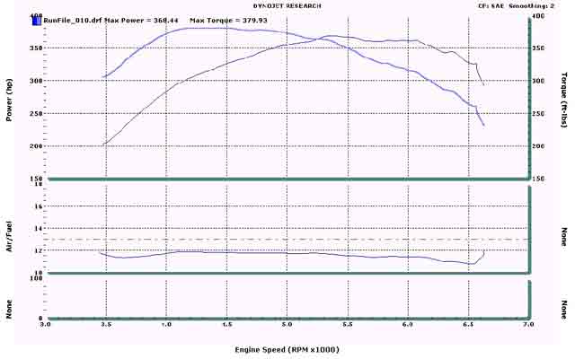

3VZE dyno baseline before turbo

Oh I'm going to try what I have for sure. Just looking out for the future. My original plan included a 50 trim t3/t4 with the smaller A/R turbine housing, but the cost of a used ct26 was too tempting. I've always wondered if a t3 turbine flows better than a ct26 turbine. I guess the answer to that would be the .84 A/R housing and I forget if you can use a different trim turbine (like O or P).
