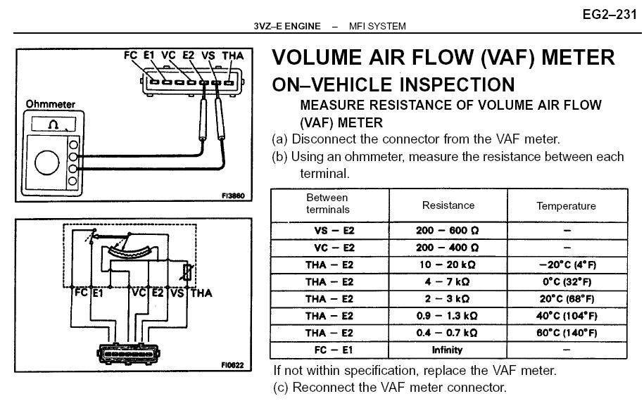

A little update: I tested the vafm (with this
) cause i read that it could cause a no spark condition.
THA - E2 was 3.05k ohms. Since it was around 15 celcius, I think it was in specs. E2 with VS and VC was good.
