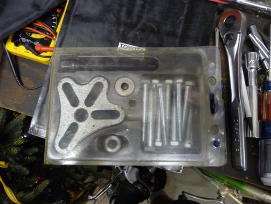

I used a pulley puller I bought at Sears. Only way I could get it off. I greased the hell out of it so it'll come off easier next time....

What type of puller was this? Do you have a link or picture?

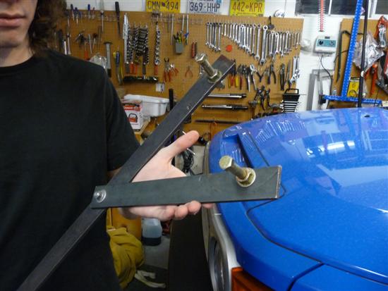

The crank gear is slip-on and isn't pressed in place. I have always been able to just pull it off with my hands with some side to side jiggling. The FSM has you put two screwdrivers behind the gear on opposite sides, and using a twisting motion, start the gear moving. If it's rusted in place you can use a harmonic balancer/ steering wheel puller to remove it. I've attached a photo of one. The crank gear should have 2 holes drilled and tapped to use with the two opposing slots in the puller.
The cam turning isn't a problem and if you take the spark plugs out it turns back much easier. You should be able to turn it by hand with the plugs out or you can put the bolt back in finger tight and use a wrench. A sharp pop on the wrench should loosen the bolt back up without moving the cam too much. You will set it to the mark just before putting the new belt on so it doesn't matter if it's off until that point. The bolt will be installed and torqued by then so you can use a wrench to set it exactly. I use a holding tool I made when removing or installing the cam or crank bolts that you can see in the photos. I highly recommend it.
If you get the seals from Toyota they will have a rubber coating all around the outside edge and seal great without any RTV. I've never seen one leak unless the head gets damaged where the seal goes. I put multipurpose grease around the outside edge and inside the housing where the seal goes and use my fingers to push it in as far as I can. The I use the end of an extension to gently tap the seal into place by going around the edge a little at a time. If it takes more than light taps to keep moving it, the seal is probably cocked and needs to get straightened before it bends. Go a little at a time watching for a high point so you can keep it straight all the way to flush.
Take care and good luck,
Bugs
