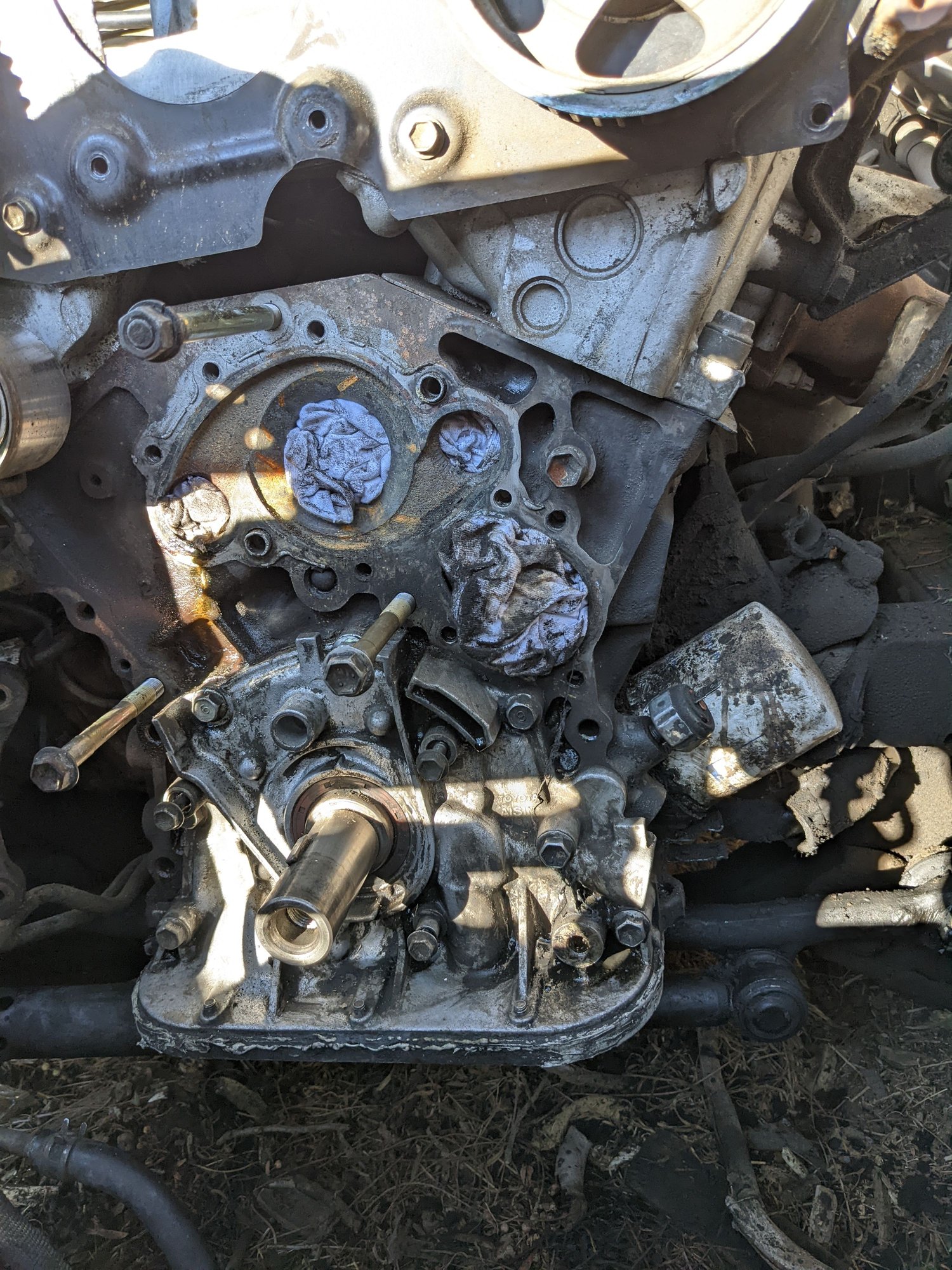

I recently refreshed a 3VZE engine back to it's glory days. The engine is a good engine giving me about 170psi per cylinder when I test compression. Good engine.
When I purchased the truck there had been a fire in the engine bay and the wiring harness was charred. Luckily I was able to drive it home but I knew I would have to replace the harness. Before removing the harness I checked error codes and was only getting code 52 with the damaged harness. When I tore in to it, I replaced the harness with a good harness that I pulled from the salvage yard. To me it was a good harness because it was not spliced, was not brittle, and all the connectors were there. While I had the engine open, I bought 2 knock sensors and 2 pigtails by accident. I meant to order only 1 set. While there I did the timing belt, water pump, tensioner, distributor, spark plugs and spark plug cables. After I put it back together and fired it up I got the dreaded code 52 again. Having and extra set of k ock sensor and pigtail, I tried the other method common in these forums of installing on the hook attached to the head of the engine. After completing this mod, I am still getting code 52. I have purchased the ATS Racing adaptor for the MR2 as noted in another thread here. I will let you know how it goes. Before I do the GM knock sensor mod though, I am going to run some tests on the pinouts to the ecu, for the knock sensor. If the pinouts test good, I will consider replacing the ecu before I do the ATS gm adaptor. I read on another post that someone resolved code 52 by making repairs to the ECU. I don't know what to test and how to test it, but I can rule out a bad ECU by doing a final test on the new wiring harness.
​​​​​​MY theory is that when the old harness burned and the wires became exposed, they shorted and caused damage to the ecu. I will keep you all updated on this post incase any of you also face this issue. I will include a more cohesive write up with pics.
