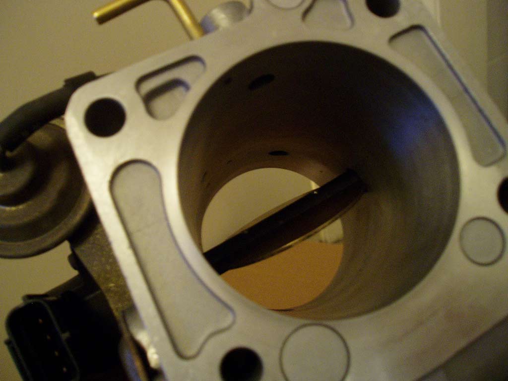

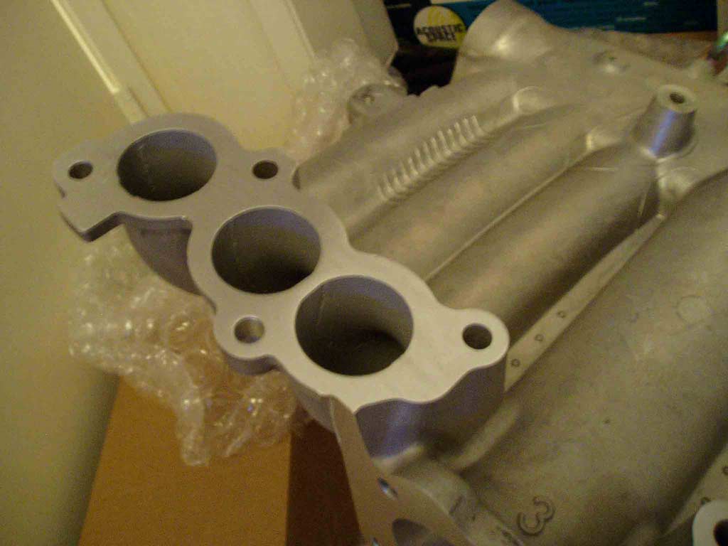

The LC Engineering bored plenum and throttlebody are on the 3vze, and I drove from Seattle to North Vancouver, ferry to Nanaimo BC for cold water wreck diving, down to Victoria (on Vancouver Island), back to Vancouver on the ferry, and back down to Seattle. I think all in all I drove about 600 miles with them on and off road.
I am really pleased, I have some observations.
-The idle is higher than before, I cannot get it below 1100RPMs. This does not bother me. I am not sure how it will affect the engine. The idle is smooth and strong.
-I need to give more gas to get torque. I can't just slowly open the throttle, I find that my foot needs to be heavier.
-The sound of 'opening up' with the headers and exhaust is a lot bigger. Sounds great.
-There is a lot more available power when I give 'er gas. Low end torque is not spectacular in 1st, but when going up hills in 2nd it is very good. Highway driving has changed too, I can floor it in 5th at 65MPH and have a strong accelleration up to 80. I am really pleased with the LC Engineering job, I am enclosing pics to show you their craftsmanship.
I am in touch with Johnny (Weasey 2K) in Vancouver and I want him to do the cams, shims, water pump and timing belt. My question for the forum is, should I do the head gaskets/valves at the same time? Also, is there any way to tell how stable my bottom end is? Is there a way to test it for stability?
I would not want to have all this work done and then have the HG go on me. =nightmare!
here's the pics. thanks!

More pics of the LC Engineering Bored and Ported 3vze Throttle body and Plenum.
Review-
LC was very easy to deal with. I sent them a dirty, used throttle body and plenum pulled from another vehicle while I continued to drive my rig.
What I got back was a beautifully cleaned and matched set that has opened up the mid and high end of the engine. The base idle speed is faster but I like it, and am very happy with this addition to my rig. Thanks LC
