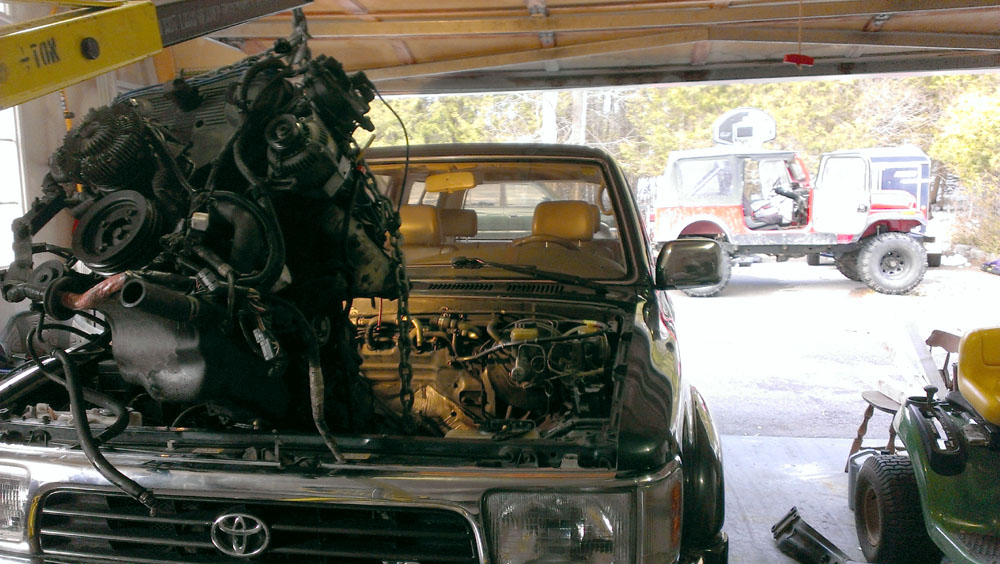

I'll definitely investigate and research this. I've located a 97 3.4 with harness/computer but it does not have a transmission/tcase. I'll have to find out if I can mate it to the 3.0's tranny..so lots more research to do.

believe it or not, I am swapping in a 22re and suspension parts from another 4runner I have.
It's not a straight forward and many wouldn't bother, but for $$$ it's way cheaper considering that I have a complete donor truck.
The engine/trans/xfer case/computer has been pulled from the donor. The recipient will get the full driveline.
There are some differences that would scare some people away.
-engine mounts are further forward (cutting/welding/fabbing involved)
-power steering is not the same, have to take donor's
-exhaust downpipe is not the same
-auto to manual (going to be drilling the firewall and adding clutch pedal)
The donor has detroit lockers with 5.29 gearing, hd coil springs and hd torsion bars..they're coming too.
-so far it's just a lot of manual work
I will try to document the progress in the swap forum soon
wish me luck
