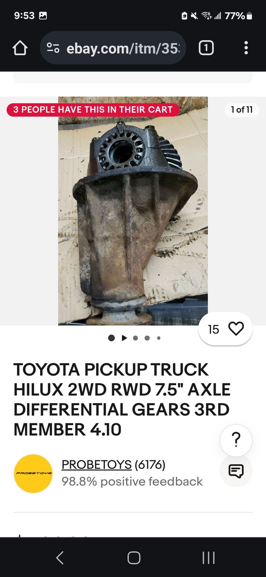

7.5 inch 3rd member hilux to tacoma
Will a 7.5 inch hilux 3rd member go into my 5 lug tacoma that also has a 7.5 third member ? Thanks in advance

I believe it would bolt up to the third member, but can't say whether the axles are the same size or spline

thanks- i am pretty sure.... they are both 27 spline - not sure about axle size....???

maybe see if the inner axle seal is the same.
