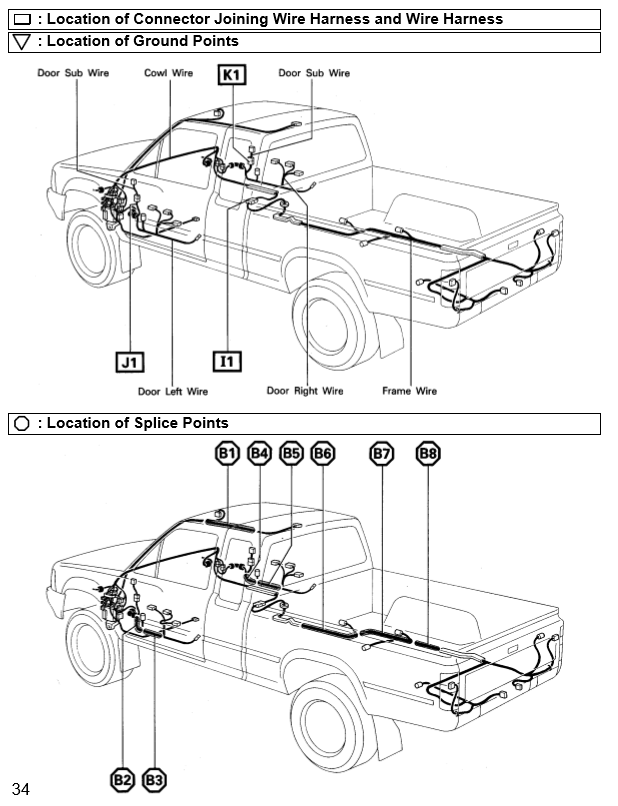

I'm using a factory light in the the factory location. Currently the wires are routed to behind the dash with about 8 feet of extra lead. I would like to keep this simple if I can.

Pin 5 (switched fused +) and pin 17 (-) of connector I1 under the passenger's seat.

Hmm, it could be a different year's plug. If you can post a pic of your plug there, that would be great. In general, it should be the green/white-stripe (switched +) wire and white/black-stripe wire (ground).

The connector under the seat is BG1, and in my '94 EWD it's shown as a 14-pin connector, with the Stop lamp on pin 5. Go figure.
Even in '94, the wire for the stop lamp is G-W. But this isn't rocket surgery. Just test for voltage to ground on all 9 pins. The one that goes to 12v when you step on the brake is the one you want.
