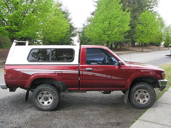

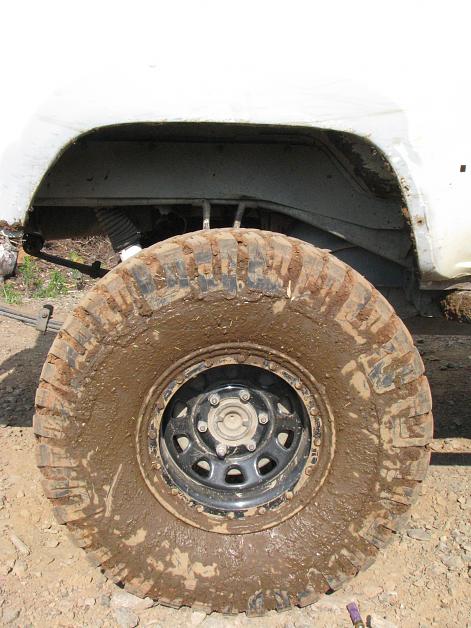

Long story short. I inherited a 90 pickup in great shape. Since then my 85 4runner has hit the back burner. Question? has anyone fitted 35's on a 3rd gen pickup with little to no suspension crank? i plan on keeping this truck in stock form (for the most part). my 30's i have on it now are VERY bald!! The meats sittin under the 4runner are still fresh!! Help!!

You'll need to lift babe... I'm running stock 31s and that's as big as you can go stock. (maybe 32s but they are rare) 33 and up you need a lift.

theres a guy on here that runs 35x12.50s with no lift on a 3rd gen pickup. x2 on boltin them up, then mark where there rubbin and
edit- his name on here is RE RE. heres a link of pics scroll bout halfway down

35s with no lift is completely possible.
Im not rubbing in any of the pics above, they tuck nicely into the fenders. I cut about 3 inches off of the fenders. Removed all inner liners and pounded back the firewall with a hammer. What you should do is put the 35s on, and see where they rub. Rims will less backspacing are going to be your friend here. Mine barley stick out. However, they do rub on the power steering pump, and on the idler arm, but only on full lock. Nice low COG. Weld the rear and wheel the piss out of it. I haven't broken a CV yet, but its probably not a bad idea to carry a spare. I still have stock gears, so no crawling, but still plenty of power in low to clean the tires out. Also, my t-bars are still at stock height to get some flex out of it.
