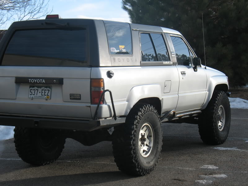

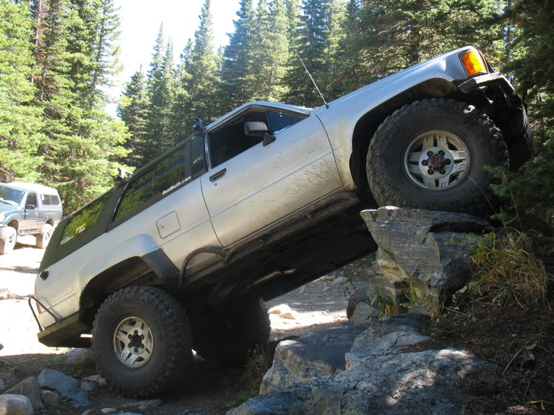

I did 35's and no lift. You can check out my 874runner thread to see the mods. I shaved the upper a-arms and tubbed the firewall. No rubbing. Its not brilliant on the steering though, so I upgraded that as well.
