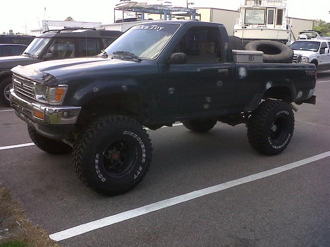

Im thinking about finding some bigger gears. Cause it struggles to run Highway speeds, and im killing my gas mileage. This is what it looks like now. IF...I can get this picture to work.
Old Apr 24, 2010 | 09:52 AM
Bojangles's Avatar
Joined: Oct 2009
Posts: 997
Likes: 8
From: Sc
Click the picture and you'll see what ive got going on
