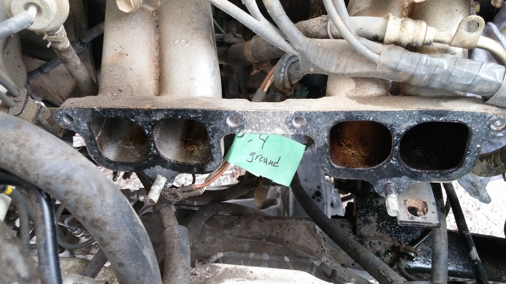

Good catch on that. That is the ground and it will need to be grounded when running the test. I will mention that on the first post so some one wont have that problem. Thanks for the post.

Today I was helping a friend work on a 93 pickup with 423,000 miles on it and it has a miss on #4 cylinder. We are getting fire to spark plug and now know it is on the fuel injector side. The injectors were recently tested and cleaned so we know it is not getting a pulse from the computer to fire the injector.
We did not have an LED to test the injectors connector but did have the 194 bulb. When connecting the bulb to one of the known good injectors, the bulb stayed lit solidly and bright. I am guessing the filament can not dim fast enough to show pulses. On an LED I get about 10 flashes per second. My guess again is the LED can react quicker to electric pulses then what a bulb can do.
When connected to the known bad injector it would be dim at times or not light at all. I am suspecting we have a bad wire or crimp that is needing repaired.
Just wanted to mention this as we were to far away to go get a LED and used a bulb for testing. Some tools just cant be found or you have to come up with a way to test things that are not conventional.
