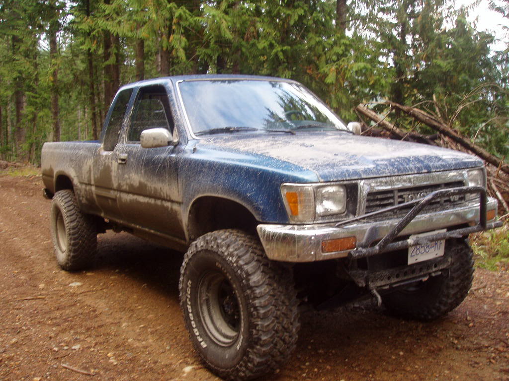

Heres my truck with just the 3" body lift, and 33x12.50" M/T's

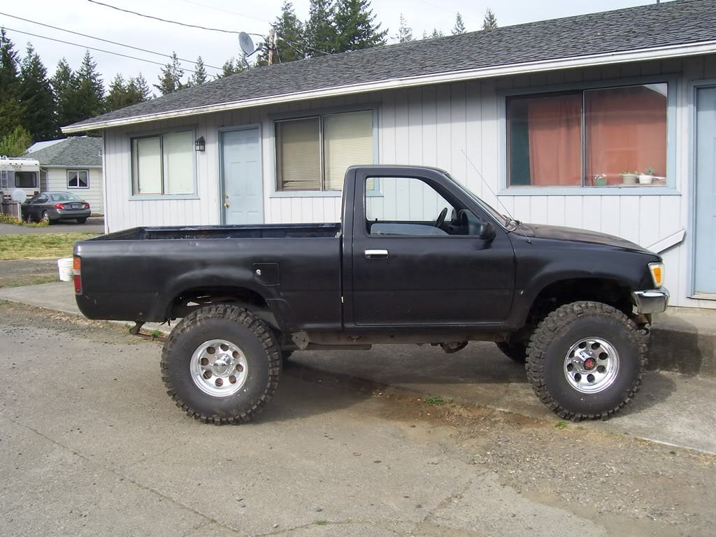

here's my 91 when it only had a 3"body, and 35x10.50 boggers,
they actually didnt rub that bad, on flat ground i could turn all the way and it wouldnt rub!

is that with JUST a 3in body lift...no other suspension mods...cuz 35x10.50 boggers...on just a 3in body lift...thats awesome..lol...i wouldnt think they would fit..
Old Mar 26, 2008 | 08:08 PM
TOYOTA 1's Avatar
Joined: Feb 2008
Posts: 2,799
From: oregon
yep no crank on the tbars, and stock rear springs! 3" trailmaster body lift!
my buddys dad has a 86 xtra cab with same BL and he runs the same tires to!
i think thay only measure 34.1/4 inches od

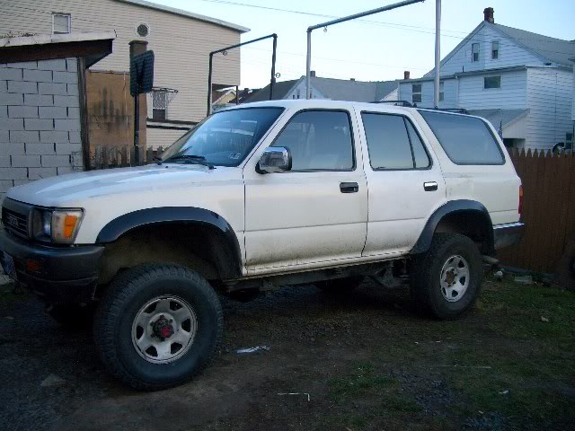

90 4runner
3" BL & 31x10.5s

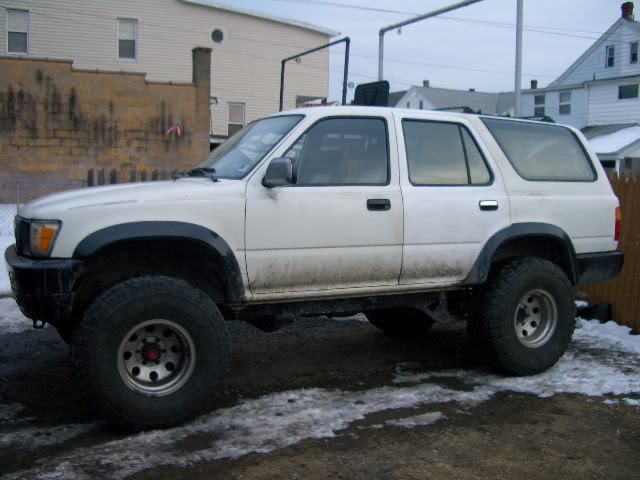

3" BL, mild t-bar crank & 35x12.5s

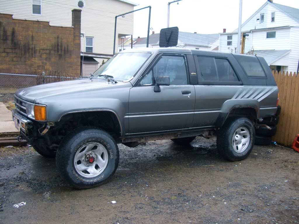

87 4Runner
3"BL & 265/70/16s
