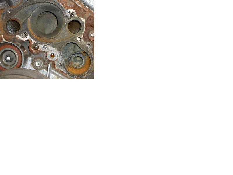

I pulled the water pump last night. I have some questions about the block. The water pump mounting area is pretty corroded. The motor sat for a few years and was messy and dirty. The moisture seems to have infiltrated the gap between the pump and the block, causing the corrosion.
I have attached a picture.
Can this be cleaned up without sending it out for resurfacing?
The surface is pretty rough, even after using green scotchbrite pad on a small area.

I did some research on the water pump mounting area corrosion issue. I'll take a dremel tool with a wire brush to it and see if it comes clean.
Does anyone have any other ideas?

I cleaned up the motor with a small wire brush, a 3" wire brush in a drill , and a pile of shop rags. It looks a lot better. The corrosion where the water pump mounts is gone. The surface is uneven and a bit rough. I am told that with the gasket for the water pump, and some sealer, and I should be good to go.

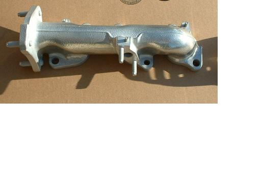

I picked up the exhaust manifolds and a few other items. The Jet-Hot Coating looks pretty nice on the manifolds.

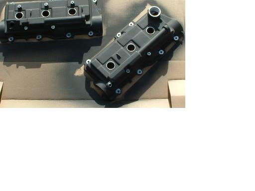

The valve covers didn't look very nice when I cleaned them up. Some careful masking and some rattle-can paint makes for a nice look. My 4runner is black.
