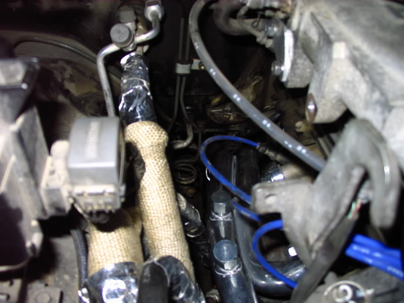

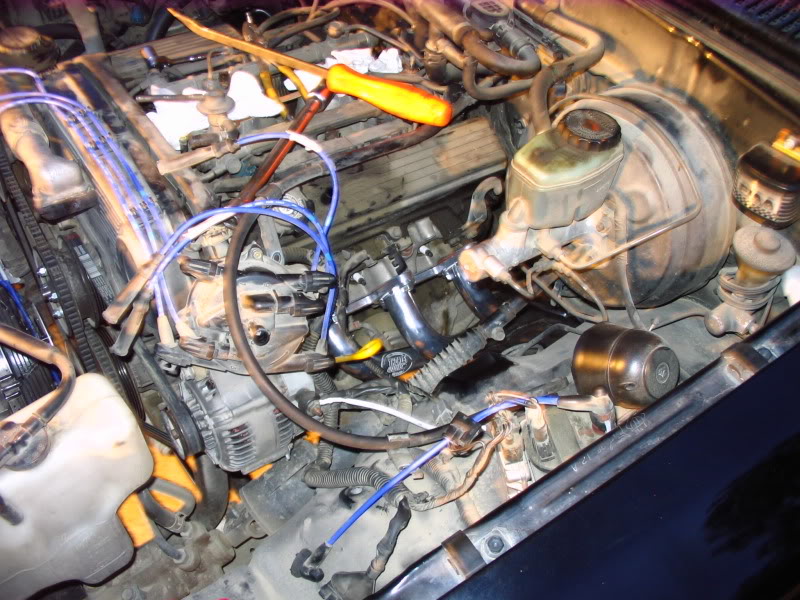

Here are a couple pics of the headers so far:

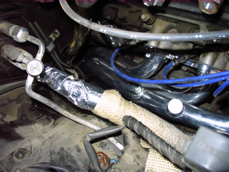

Passenger side was easier than the drivers side, the header slipped right in. I wrapped everything near-by in heat tape: starter, brake lines, fuel lines, AC, wires, I think everything should be okay for heat. I got a big adhesive backed heat shield for the firewall, looks like it should do the job. Having the intake manifold out and all the vacuum lines disconnected definitely helped.

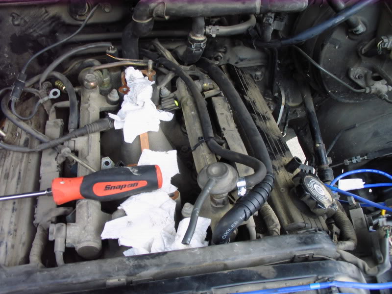

I had the manifold and vac lines out to service the injectors and set the valves.

Here are all the pictures I took:

I used a lot of foil header wrap, foil mat for the firewall, then I ran out and used aluminum tape. So yes, header wrap would work, but I would get foil faced tape. I kind of looks like hell, I will probably order some more foil tape from Summit and clean it up.

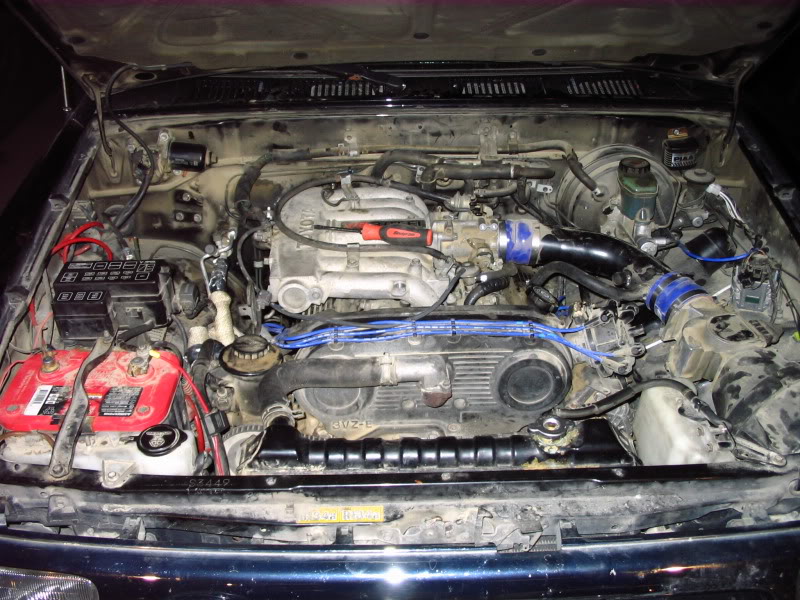

just installed mine word of note on sas truck you will have to cut the y pipe up but you can make it work with out using any extra pipe
still have to finsh the y pipe back
you whent heat sheilding crazy
here is mine

re rooted my gas liens and clucht line and by pass the coolent into my thottle body
and how she sits so easy to work on
