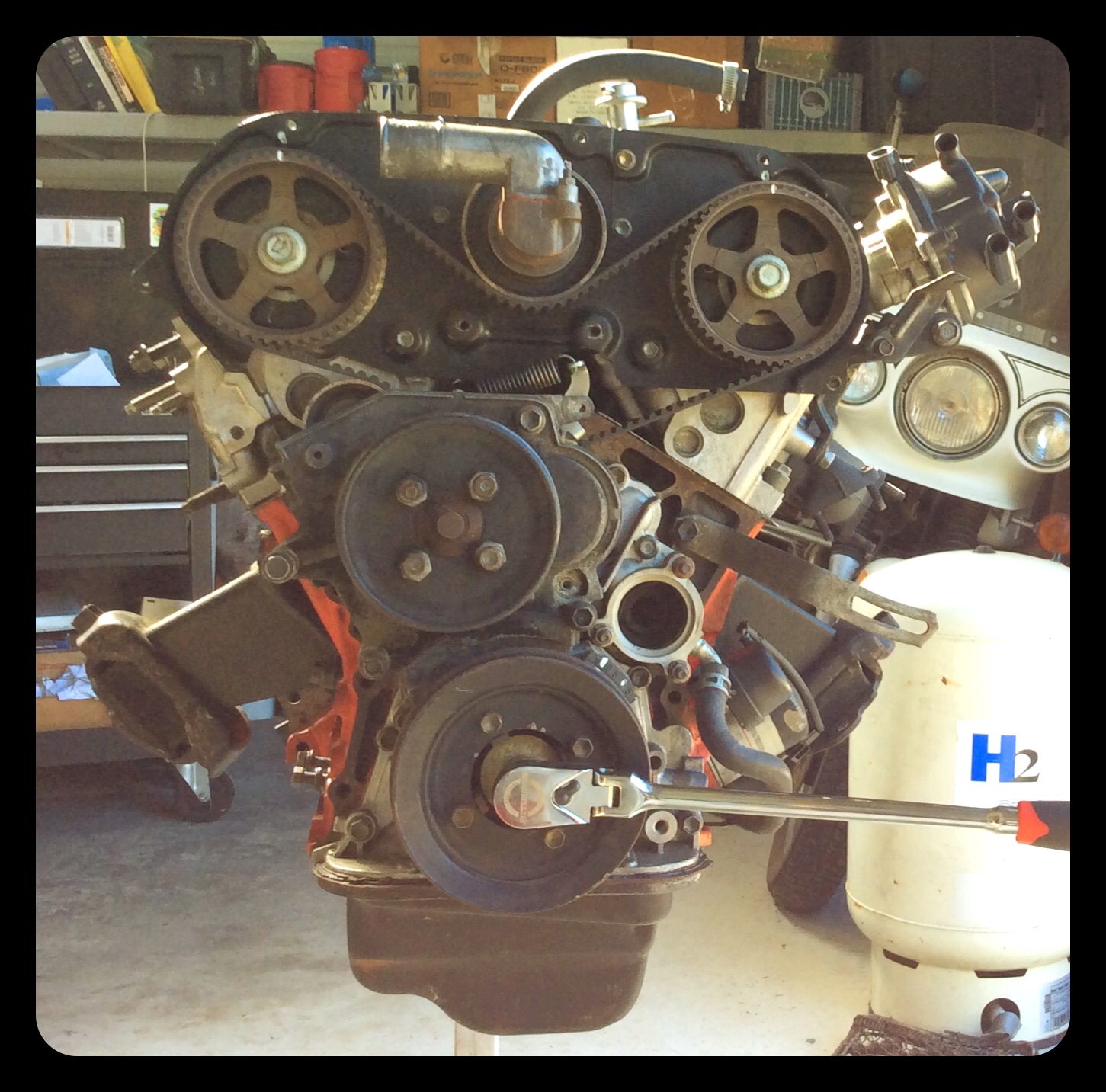

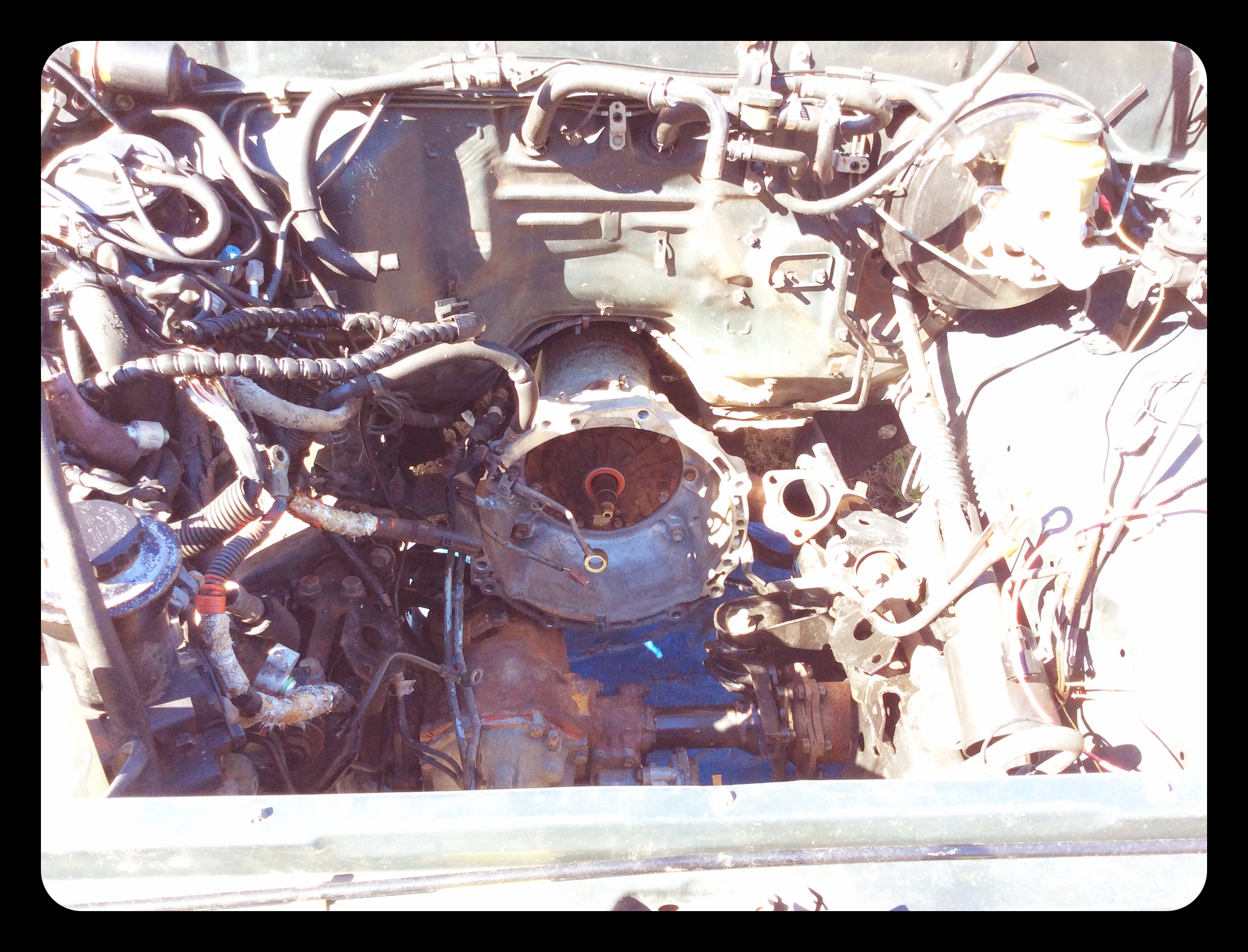

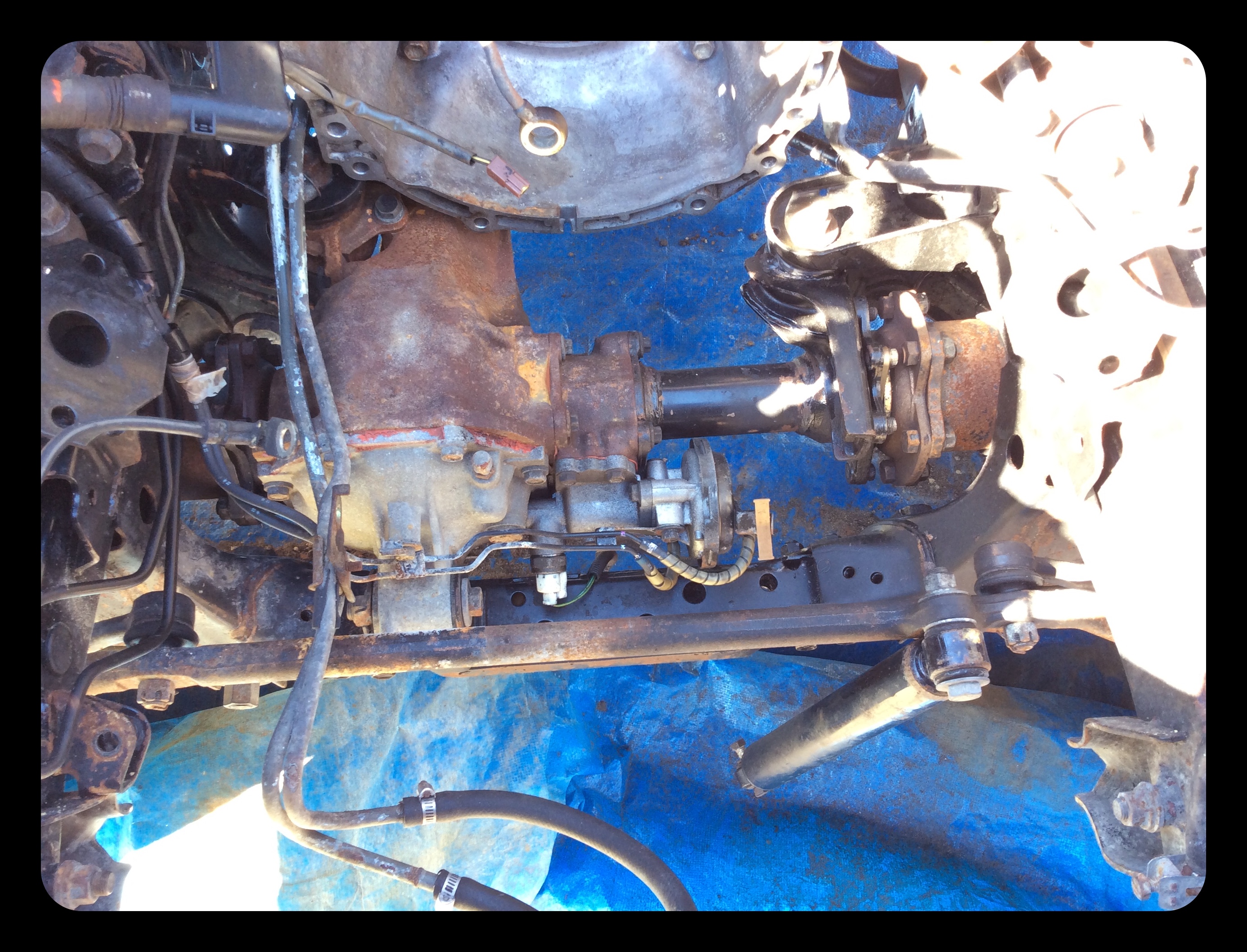

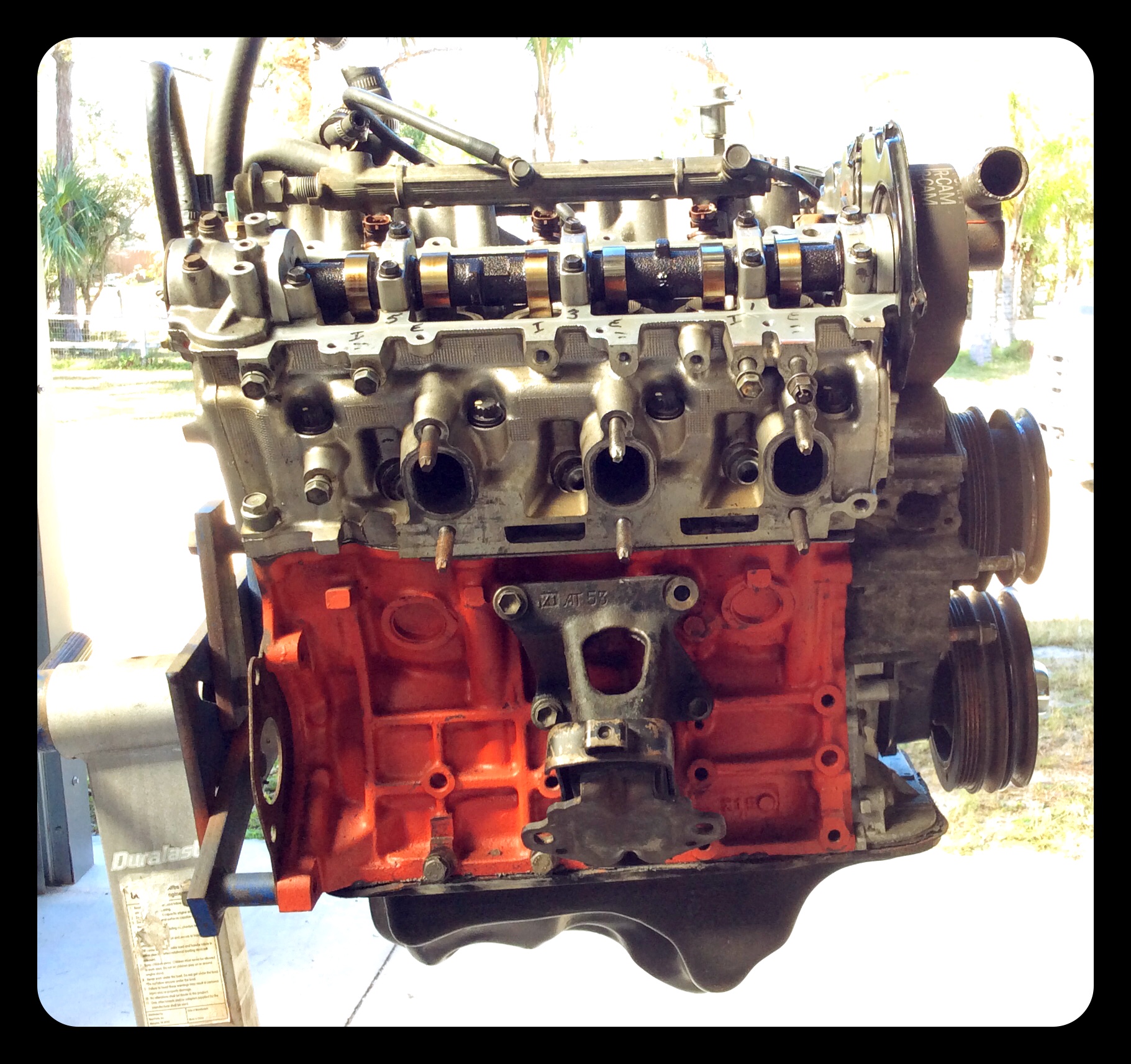

Old Feb 1, 2017 | 12:18 PM
  #35
Budman1's Avatar
Joined: Oct 2014
Posts: 84
From: Sebastian, FL
Didja miss me?
my wife and I spent three weeks with the grandkids round Christmas, came home with colds, took three weeks to become social.....y'all didn't even know I was gone.
I've cleaned the engine bay, green stuff and oven cleaner, pressure washer.....
I checked the valve clearances on the stand, changed shims trying to hold clearances in the middle of acceptable, NOTE: I did have to purchase (3) shims, after looking on line, I called a local Toyota Dealer (Shout out to Toyota of Melbourne, their parts department is great, everyone I talked to treated me like 'the Donald'), manager Steve Bowman, great prices too,(is that ok Mods?)
Next up is valve covers, exhaust manifolds......I'm deliberately:::::use standard exhaust system or eliminate the crossover, tie right exhaust back in before the cat,...so here's a question, if you're buying this/a 4Runner, 3.0, would the removed crossover be a good thing, bad, or who cares?
I'm not in a hurry, just keep wrenching
Attached Thumbnails 3.0 vz---Sounds Like a Stuck valve, but????-img_2118.jpg   3.0 vz---Sounds Like a Stuck valve, but????-img_2119.jpg   3.0 vz---Sounds Like a Stuck valve, but????-img_2121.jpg   3.0 vz---Sounds Like a Stuck valve, but????-img_2122.jpg
