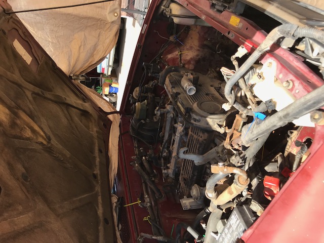

I have all most everything disconnected except the front exhaust pipe flange. Nuts are rusted big time.Any ideas before I use a sawzall? Had to make some shade , (no trees). been 100 deg days lately.

Been there, done that.......take pictures before disconnecting, every part and bolts into a labeled container, pay close attention to all electric connections, and...take pictures..

Originally Posted by amamike91
I have all most everything disconnected except the front exhaust pipe flange. Nuts are rusted big time.Any ideas before I use a sawzall? ..............
I would use PB Blaster, then using a 6point socket...1/2” drive, driven on if necessary.. something has to give

Thanks everyone for the input. I have been taggin and baggin everything.
. My 90 Toyota Extra cab 4X4.
I removed this water manifold so it would not get damaged when I pull the engine/trans.
Trying to stay cool in 100 deg heat. Worked better than I thot it would. Thanks old87yota picture instructions worked great.
