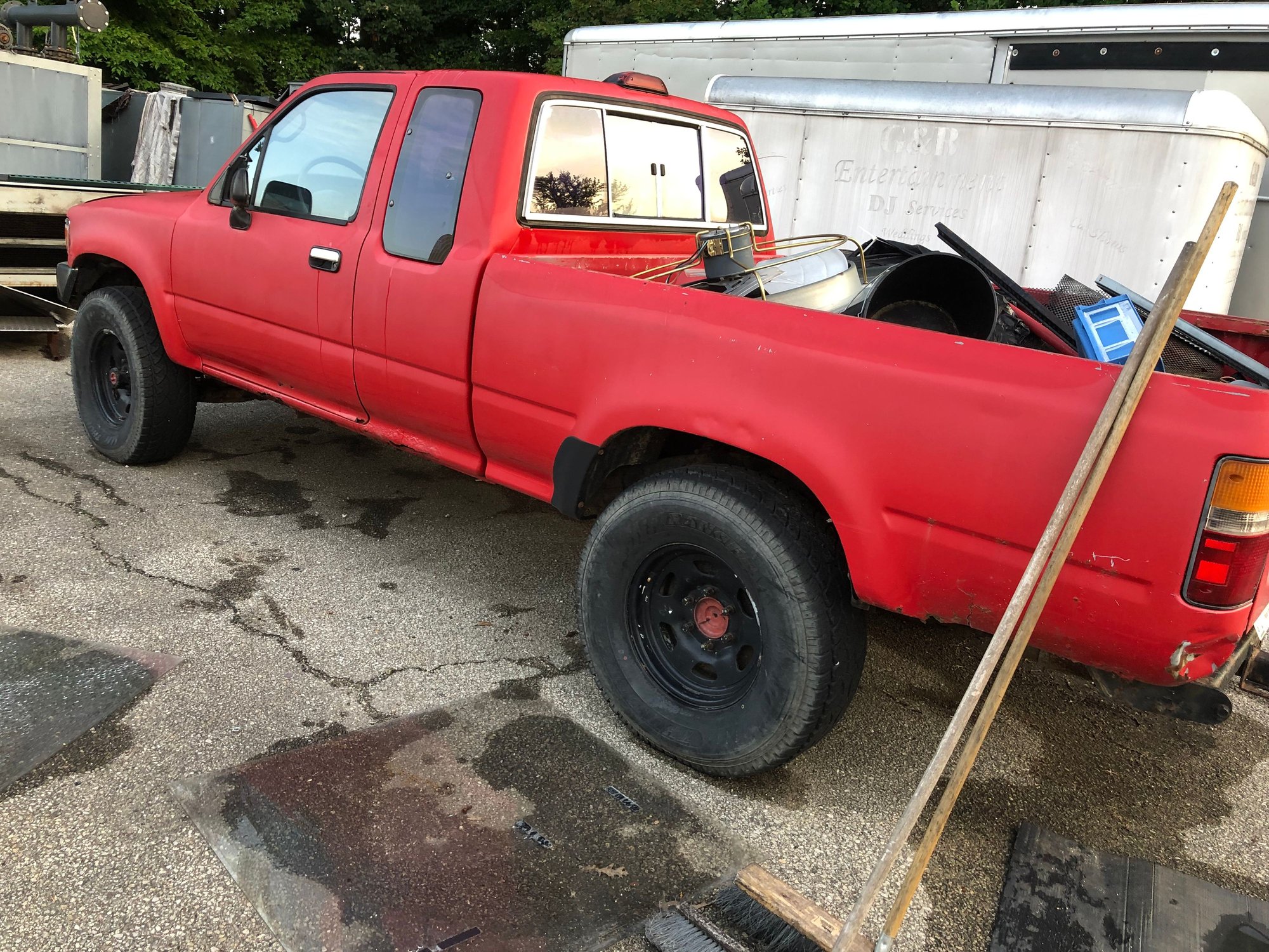

Attached is a picture of the truck, just cuz.
I’ve shown it some love since this photo was taken. This was the first time I had laid eyes on it.
