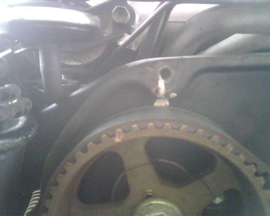

Another thing I am having is a ticking noise, I think it is the pulley between the cam gears that the timing belt goes under. does anyone know the name of this puley so I can order the right one?
Old Jun 13, 2009 | 11:39 AM
  #24
Turtles Runner's Avatar
Posts: 13
From: WVC UT
here is a pic of the timing cam before I moved it, they were both the same. Crazy that it was still running
