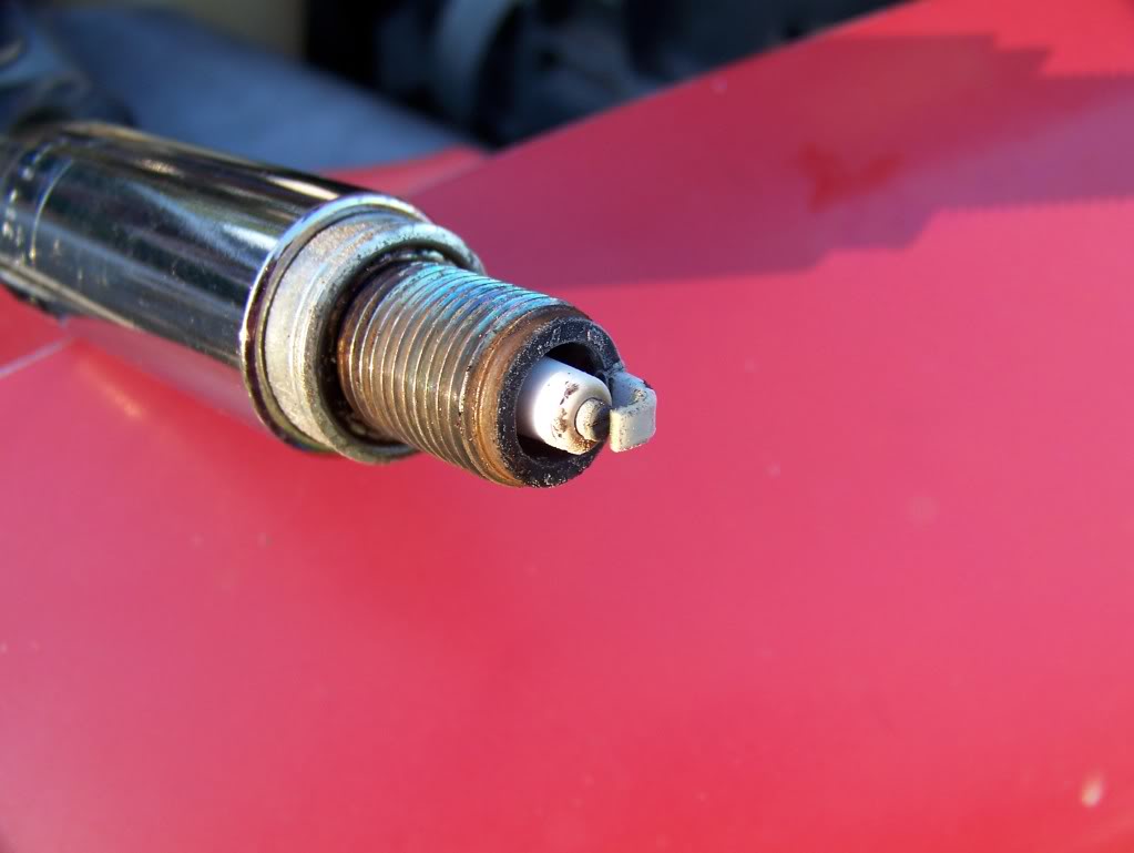

The reason I want to replace it is because I believe my truck is running rich, low mileage at or less than 10mpg, smelly sooty exhaust. I know the coolant temp sensor has not been replaced in at least 10 years, probably never, so I figure it wont hurt to replace it anyways. I have already replaced the O2 sensor, cat, TPS, checked the AFM....new Toyota dist. cap and rotor, probably other stuff I am forgetting.
I just pulled the number 1 and 3 plugs to take a look, they look more like lean running plugs to me. These are NGK R BKR5EYA and have been in the truck for less than 10k miles.
Plug #3

The plugs don`t really look that bad. When you replaced the 02 sensor did you use a Denso 02 sensor ?, Bosch 02 sensors don`t work well in toyota engines. Another thing that`s effecting your mileage is the winter gas. I also se that you have 31'' tires, that more than anything will effect your mileage, have you ever considered regearing ?, that would help you a lot right there.

The plugs look good, a little worn. Might be a little on the lean side, I would check for a vacuum leak? imo
